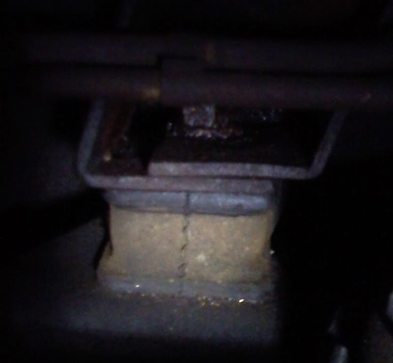

That looks exactly like what I have. The ones on the car look completely different. I'll upload a pic in a minute.

This is taken from the driver side, looking down at the engine. There are no ears on either side and there is only one stud coming out of the top (I think there are two on the bottom but I didn't crawl underneath the car last night). Both sides are pretty much like this, I think they are the same.

can't make out the picture very well. But mounts for a 69 "A" body are different then for a 70. Check them.

It seems that the mounts on my car are '69 style. We looked them up at napa and they look like a much better match. The 70 style are just completely different.
Does this mean that I probably have other 69 parts on my front end as well? :?
