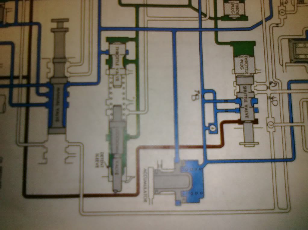

Like I said,never tried it,but I'm not too sure a '68 V-8 VB will work in an '83 S/6 case.Here,look at the pics.Both pics are from a 1971 plymouth service manual with the trans shifter in "drive" and in second gear "kickdown"Image
This is a S/6 904 trans vs a V-8 trans.Look at the differance with no 1-2 shift control valve, and no 3rd circuit to the accumulator.Image
The safest bet is to NOT mix and match parts between L-U and non L-U trans,and keep the valve body matched to the trans case.
V8?? We don't need no stink'n V8!! Image
