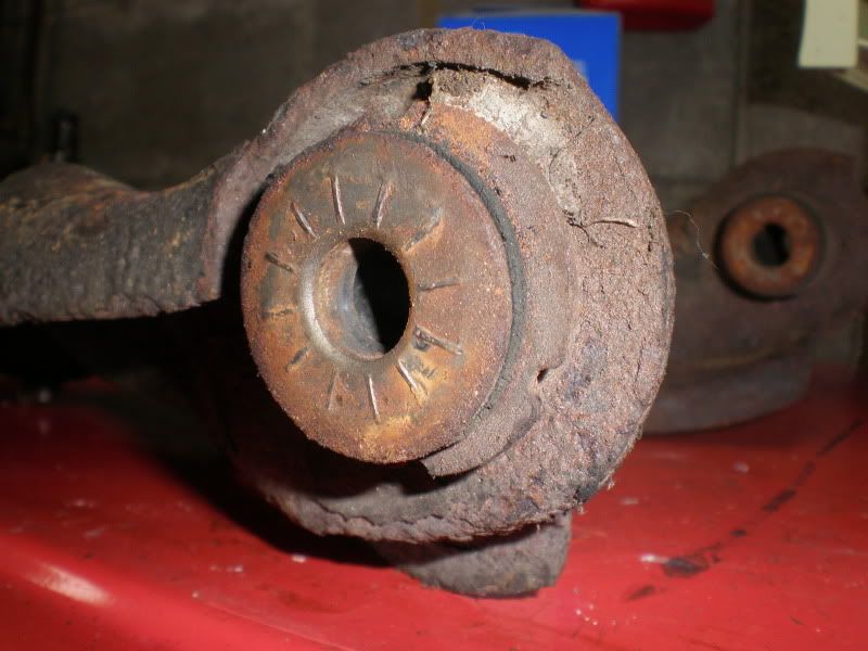

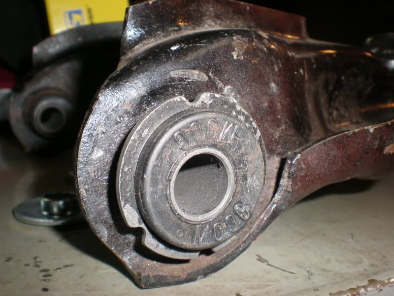

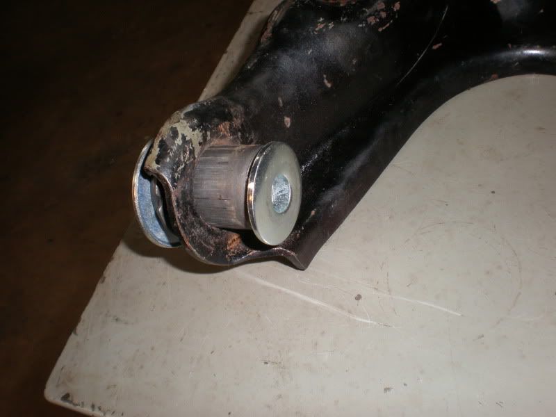

I am just doing this swap on my 69 Dart.
The washers supplied with the moog kit will get pressed on after the Bushing is pressed into the Arm.
Here are some shots:
Old Bushing with STD size washer:
And NEw Moogs:
Before Washer install:
After Washer Install:

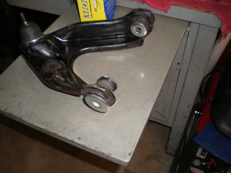

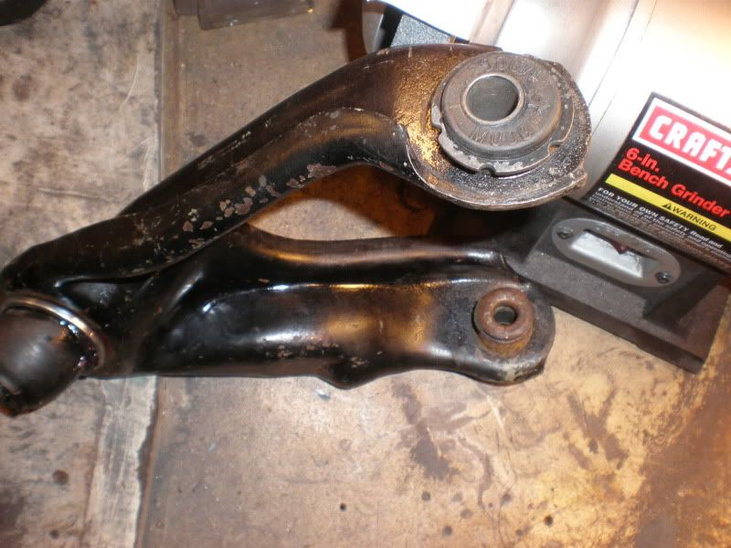

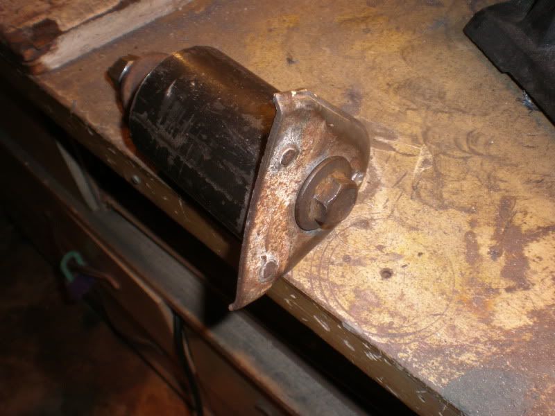

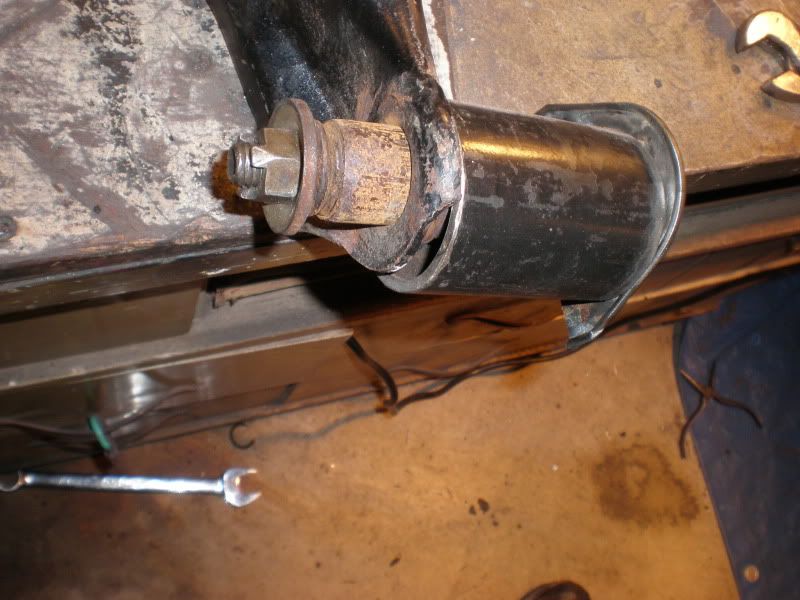

Got this project done correctly this time.

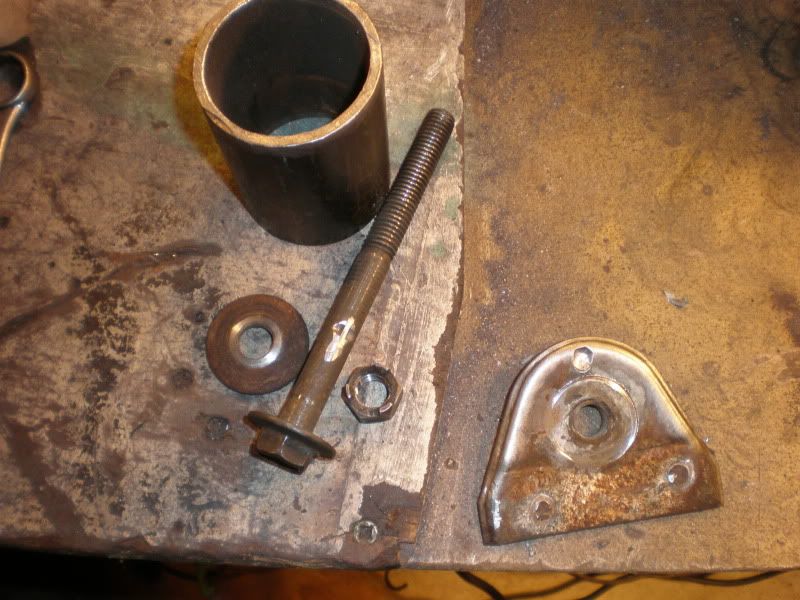

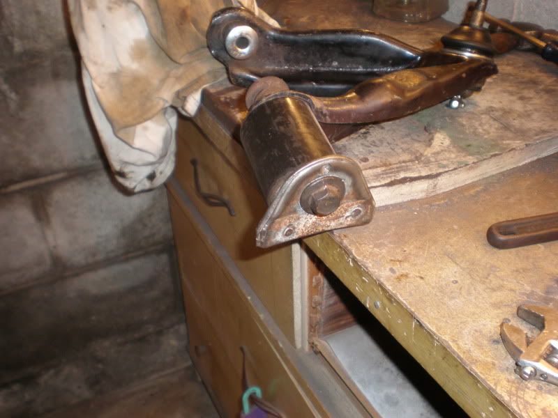

Usually when I am replacing bushings I have no intentions of keeping the old bushings so I have not had a UCA bushing remover tool.
I do have a shop press so putting them in has never been a problem :-)
Here are some pics of a remover that I made using all recycled mopar parts except for a 3" length of pipe.
-3" length of pipe ( not Mopar)
-old spool mount motor mount bolt.
-old tie rod end bolt retapped to 1/2-13 thread.
- old shock washer drilled out to 1/2"
- Seat belt Reinforcement plate (removed from race car) Drilled out to 1/2"
Also a Pic of the New A arm with the bushing(s) installed the correct way.
