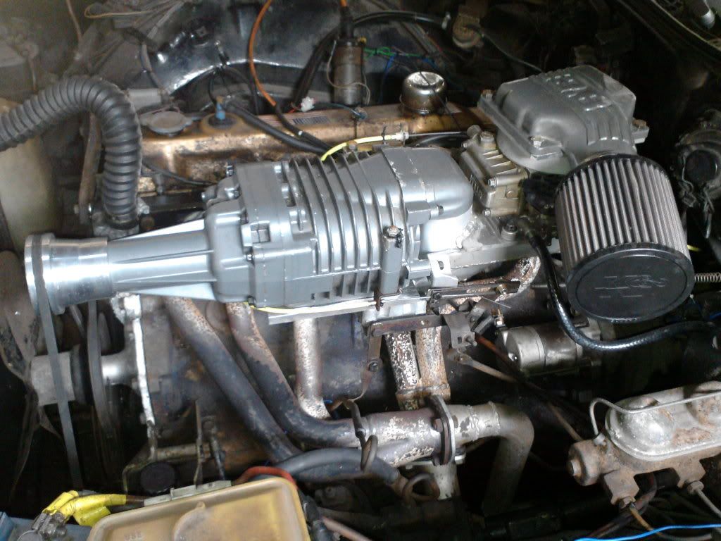

I've fitted an M90 onto my slant, i modified a stock alloy intake, and made a long pulley to line up with the PAS belt. I'm using a draw through system with a 600cfm holley (probably a bit big, but it was free...) I need to spin it a bit faster, as I'm only getting 4 PSI boost, but even that is enough to completely transform the car ( full-size 1975 C-body Plymouth Gran Fury ). Go for it! just the whine from the blower makes it worthwhile! good luck, Graham. (in the UK).

 Post subject: M90
PostPosted: Sun May 22, 2011 2:03 pm
Joined: Sat Apr 25, 2009 3:11 pm
Posts: 6
Location: Birmingham, England
Hi, This is my first attempt at posting an image, don't know if it will work!, this belt drive was meant to be temporary just to get it running, it works fine but I intend to replace it with a better looking system sometime. Clifford headers into a true dual system, sounds awesome! The carb manifold is a bit convoluted, but I wanted it to fit under the bonnet (Hood) without bulges or cut-outs.Image
PostPosted: Sun May 22, 2011 2:48 pm
Posts: 5835
Location: Burton BC canada
Blown slant C-body.....you are my hero today.
Post more.
