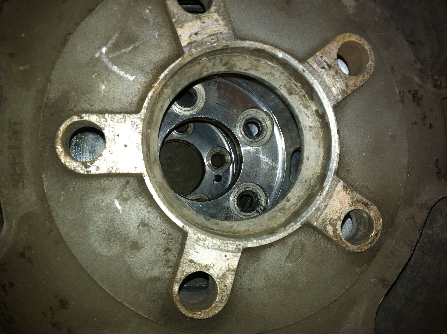

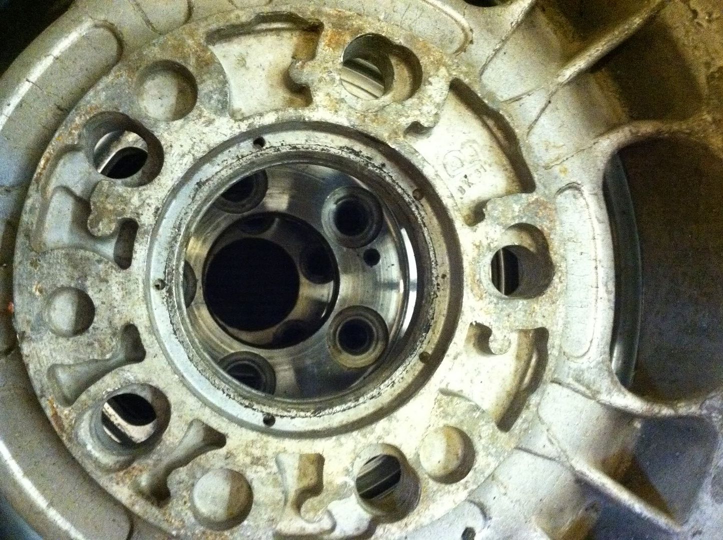

I took a closer look at the backside of the rims I am thinking about getting redrilled and made an interesting discovery. The centers of the rims are not one uniform thick casting. Both styles of rims that I have have clear bosses cast into the body of the rim where the lug holes are supposed to be drilled:
Ansen Sprint bosses
Fenton "Gyro Racing Wheel" bosses
The design of these rims makes clear that second set of bolt holes cannot be drilled in between the original bolt holes. Any modification of the bolt pattern on the rims would have to be done on the existing bosses for the holes. To redrill these rims for a different mounting pattern, I would have to either make these unilug rims or fill the holes and redrill them. I would rather fill and redrill. Couldn't the holes be filled by tigging them? Then have the right pattern drilled in the rim and get the front of the rim machined for the proper style of lug nut and washer? Hmmmm :?
Ansen Sprint bosses
If you are starting with the 'big bolt ford pattern' first thing you should do is measure the center hole and see if its small enough for the 'car' pattern. If the Fenton wheels are the same 'big' pattern just turning them into Uni-lug would be the easiest, AND cheapest to do, IF they will go that small. By the pic the smallest they would go would be to make them into a Ford 'Truck' pattern to a large GM pattern (5X5). I have done the GM 5X4 3/4 down to the Ford/Mopar 5 X 4 1/2. ( With a Die Grinder with a cyl shaped burr and lots of lube). But from the 5 X 5 1/2 to the 5 x 4 or 4 1/2 is going to be a stretch... Most shops (but not all) don't wanna really 'mess' with trying to re-invent the wheel from all of the checking with the shops here locally.
And as for tigging the holes closed, re-drilling, re-machining of the bolt holes you would have more in the wheel than what you can buy the proper wheels to begin with.
