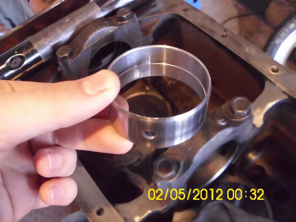

So we are putting new cam bearings in and noticed that the rear bearing has only one hole but there is two oil holes in the block?
We threw away the old bearings so we are not sure if how this works with one hole in the bearing.
its a 1970 225 slant. that we are changing from solid to hydraulic
[img] http://s922.photobucket.com/albums/ad61 ... CI0159.jpg

The rear cam journal on the hydraulic cam should be grooved. As long as the oil hole in the bearing lines up with the oil feed hole in the block, you should be good to go.

There should still be an inlet hole and outlet hole I would think. Figure out where the second hole needs to be and drill it.
What brand bearings are those? I was told that grooved bearings are no longer available. :shock:

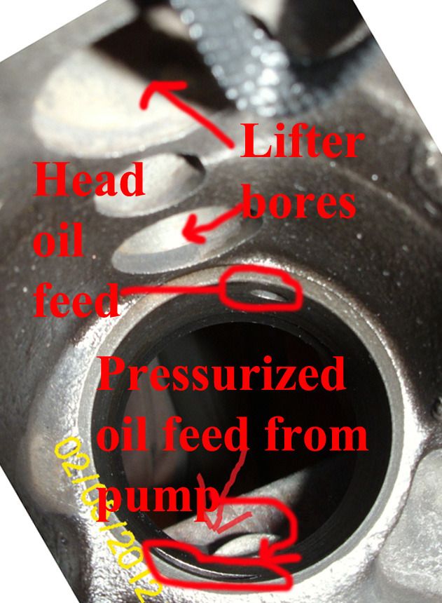

i believe the freed hole is the one with the red arrow. But what about the other hole? does it not get any oil running to it?
<img src="http://i922.photobucket.com/albums/ad61/Travman185/DSCI0161.jpg" border="0" alt="Photobucket"></a>
And the camshaft i bought does not have a groove. its a comp cam and it says its a hydraulic cam. Will this cam still work?
its my first time rebuilding a engine and im a little confused with this :shrug:

That is for a hydraulic motor, but mechanical lifter motors use the same oil passages. I believe Slantzilla is right and you will nee to drill (and chamfer) a second oil passage hole.
I took the liberty of editing your photo to label the landmarks:
It looks like you MUST drill another hole to either supply oil to the head or to accept oil from the pressurized gallery coming off the pump. When it comes to the rear cam bearing in a slant six, remember what the doormouse said, "feed your head."
Sorry, I couldn't resist. :lol:

That is the front bearing

:oops: Yes, that is the front bearing. Sorry if I wasn't clear, Charlie is right- the groove goes in the hydraulic cam rear bearing journal on the cam itself, not on the bearing.
