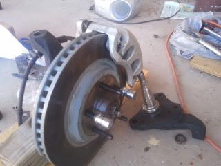

This is going to happen. Just some teaser picts.

I got the Hubs back from the machine shop. They cut the rotors hat section off, turned the snought down a tad for the new rotor to slip on and be hub centric, also help locate the rims. And they turned the outside diameter down alittle just to allow the rotor to seat on the hub.
I cant wait to get these installed. Hopefully in the next week or 2. I am going from 9in drums to 12.5 rotors with dual piston calipers. Here is a rough price break down so any one looking at doing this can have an Idea.
73+ abody disk break spindles used from junk yard. $120.
Ball joint addapter sleves. $40.
73+ abody used rotors from junk yard scrap pile $20.
Bearing seals dust caps. $30.
SN197 Mustang Take off 12.5 Rotors, calipers and dust sheilds break hoses $200.
Moser 3" long wheel studs $32.
Machine work for the Hubs $80.
So far About $522. Not including new steel break lines and master cylinder required.
Also need to fab up a caliper Bracket.

Slow progress but its still moving forward. I got the rotors installed on the spindles to start mock up. Measured the gap and bought my material for the Caliper addapaters. I need to finish the CAD program and then I will cut the brackets on the plasma table. Once they are done and test fitted if there is intrest more brackets could be cut. I also plan to make the splash sheild work to keep the area cleaner by using the mustang splash sheilds and factory mopars blended together.
The K-frame was pulled and I welded over the poor factory welds, boxed in the triangled holes and the lower control arms are ready for the stiffner plates to be welded on.
