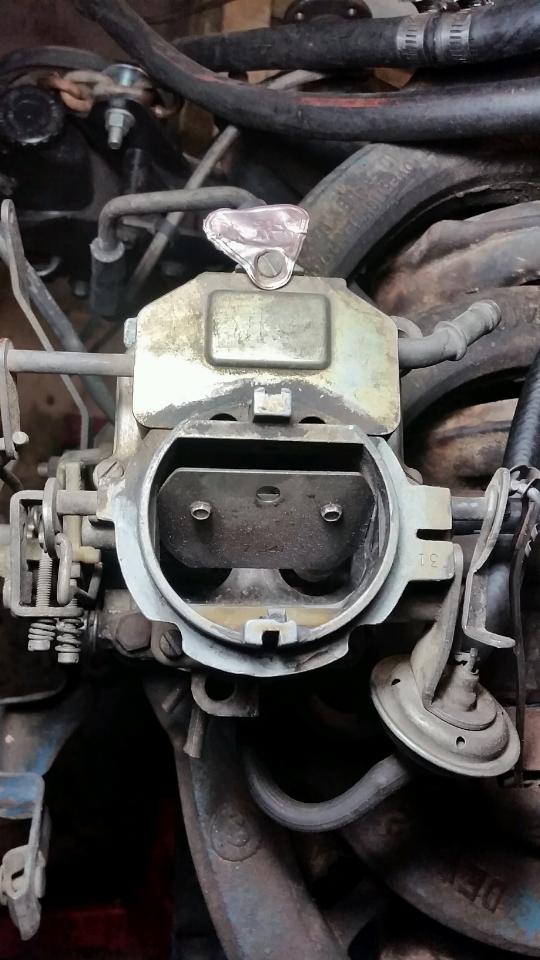

Hi,
I have a Carter 2 barrel carb and am trying to order an air filter for it. I don't have any attachments for the air cleaner hold down to feed into and some research on this site I wonder if I need an oil bath filter. If so, is there any sort of conversion to a paper filter? I would like to install a velocity stack of some sort, but don't know the name of the part I need. In laymans terms, I need the thing that the air cleaner hold down goes into and some sort of thing that holds the air filter.
Sincerely,
Paul Barrow

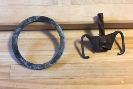

You need one of these:

Thanks Matt,
What is that called though so I can look it up?
Paul
 Post subject: Re: Air filter quesiton
PostPosted: Tue Feb 25, 2020 5:36 pm
Posts: 246
I have always heard it called a bail also you need one for that 2 barrel carb.
Brian
63 Plymouth Valiant Wagon
PostPosted: Tue Feb 25, 2020 9:24 pm
Posts: 156
Car Model: 1962 Dodge Dart
Thanks Brian,
I'll start googling tomorrow.
Paul
PostPosted: Sat Feb 29, 2020 12:41 pm
These carbs were common on 318 V-8's so you might find one a bail and an air cleaner on one in a
yard 70's-80's mopars (cars, trucks, vans....), don't think you'll find a velocity stack for this carb,
you may need to go to a Holley 0-7448 and adaptor for that.
