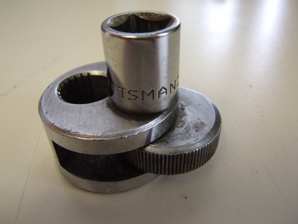

Below is the stud remover I used. Works quite well as long as you keep the base of the tool flush against the block (to avoid side-loading the stud as you turn it). With such dainty studs, really is a fine line between breaking them loose and twisting them off.
Oh well, we'll get there...

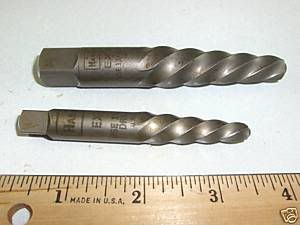

Tried an appropriately-sized one of these in a tap handle (after more torching) this afternoon...alas without success. It "bit" into the stud, but I was afraid of snapping it off if I applied too much torque:
obliquely-inclined state of mind

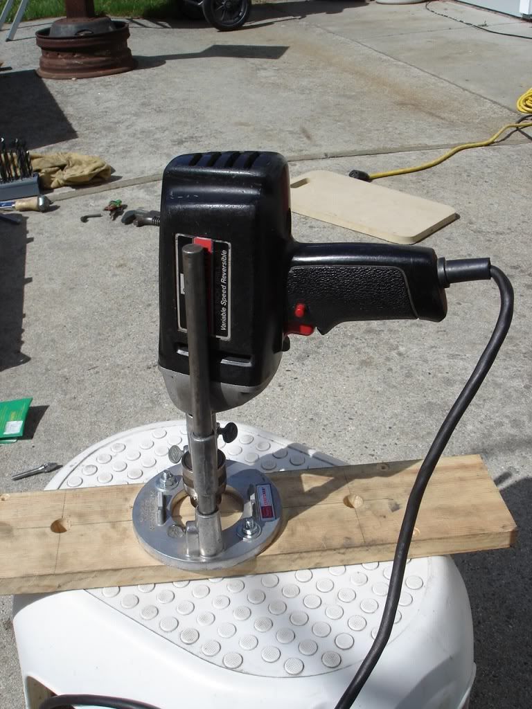

Got the end stud holes all cleaned out. This thing helped keep the drill running true/perpendicular:
I bought this device back during the '70s and the company has since gone belly up. You can still find them around, though. IMHO, they are superior to a similar item (currently manufactured by another company) which allows for angle-adjustment of the base, but doesn't stay locked into a given angle very well.

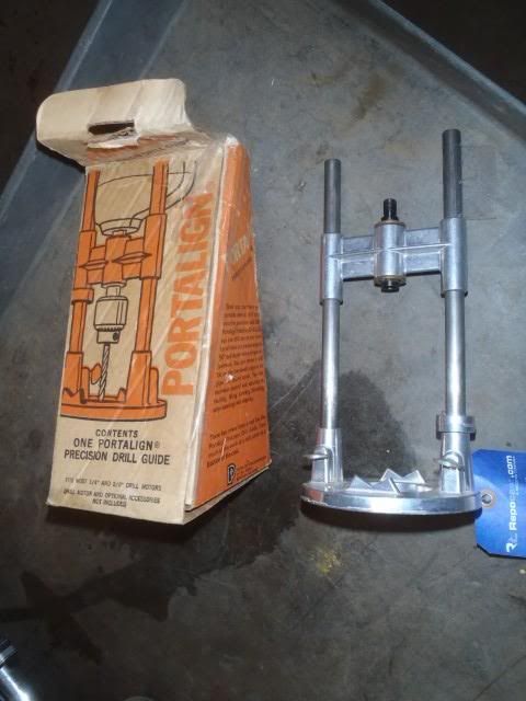

PostPosted: Sun Apr 29, 2012 7:27 pm
I've got one of those............
but don't have the box.
