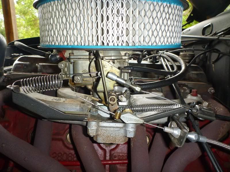

A slant 6 2 barrel accelerator bracket(Australian) with a bracket welded
on underneath will work for both cables.
I will get you a photograph of the bracket i will be using.

Here's the pics,as you can see i now have a Stromberg WW on instead of the Carter,but the bracket owrks the same for both crabies.
