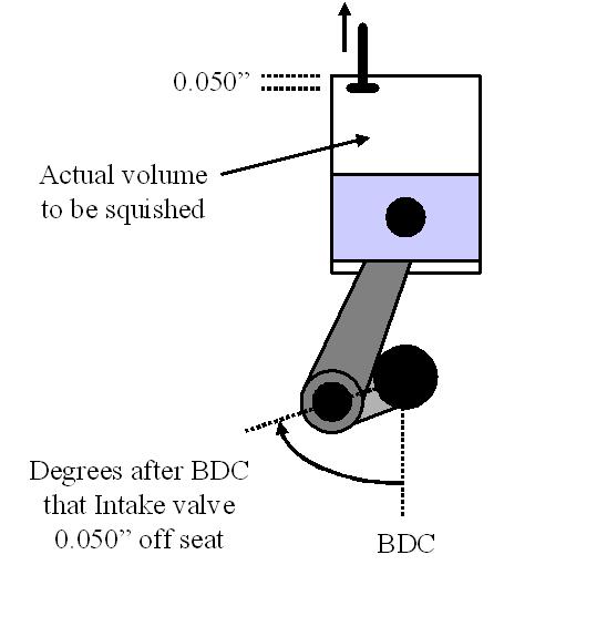

http://www.rbracing-rsr.com/comprAdvHD.htm
Try this calculator. DCR depends on when the intake valve closes (0.050"travel remaining). This is the point at which the compression stroke is essentially sealed and begins compressing.
