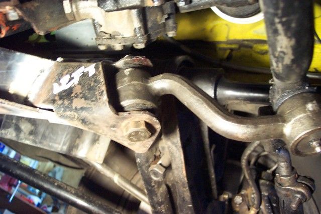

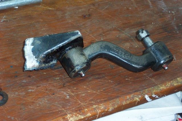

After waiting for USPO to get a check out to Doc on the West Coast and the parts delivered to Maine, additional waiting for my mechanic to look at the repair job and turn it down, and waiting another week to get car onto welder’s shop lift, the conversion has been completed.
In Maine there are welding shops all over that deal with automotive rust problems. The fellow that worked on my car fits that ilk. He amputated the dreadfully designed ‘67 one year only idler arm mount appendage, and grafted on the part Doc provided in about an hour.
Amputated 67 mount:
Conventional mount in place:
A little cleaning & paint is all that is needed to finish the job.
The car The front end with its recently installed new lower ball joints, and now a solid idler arm attachment has tightened it up nicely, and now needs a front end alignment, as the toe setting has most likely been tweaked a bit due to the recent parts replacement.
