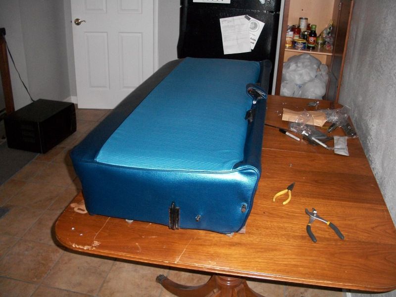

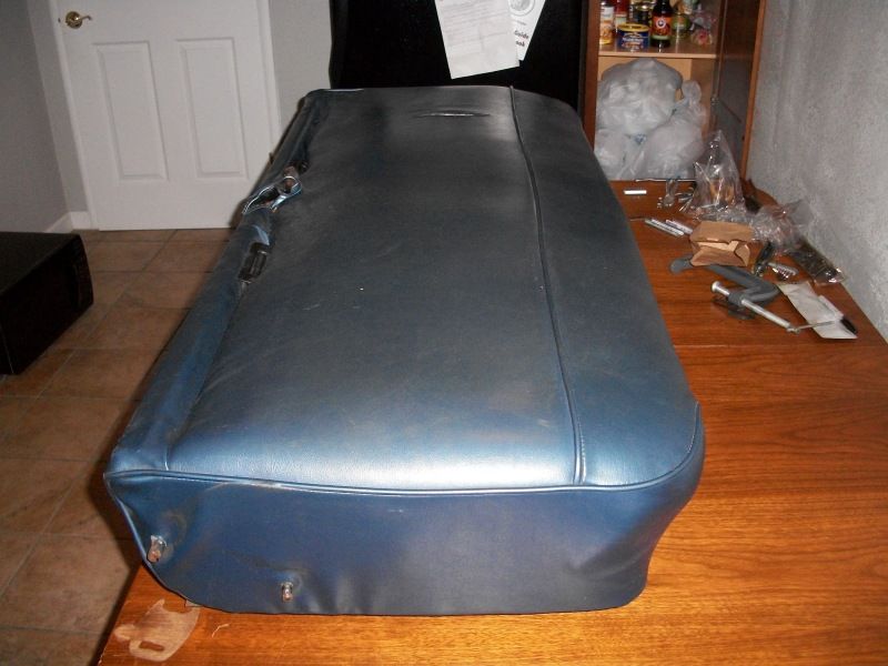

Old back seat bottom.

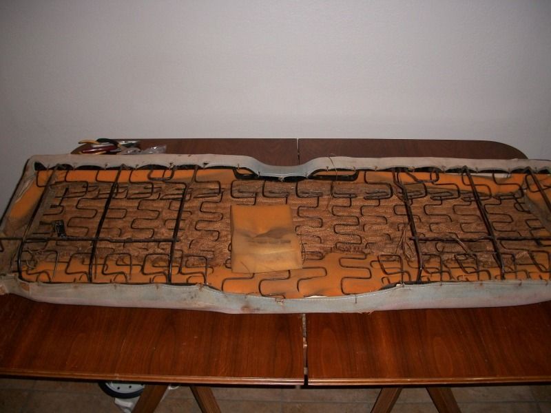

Underneath.

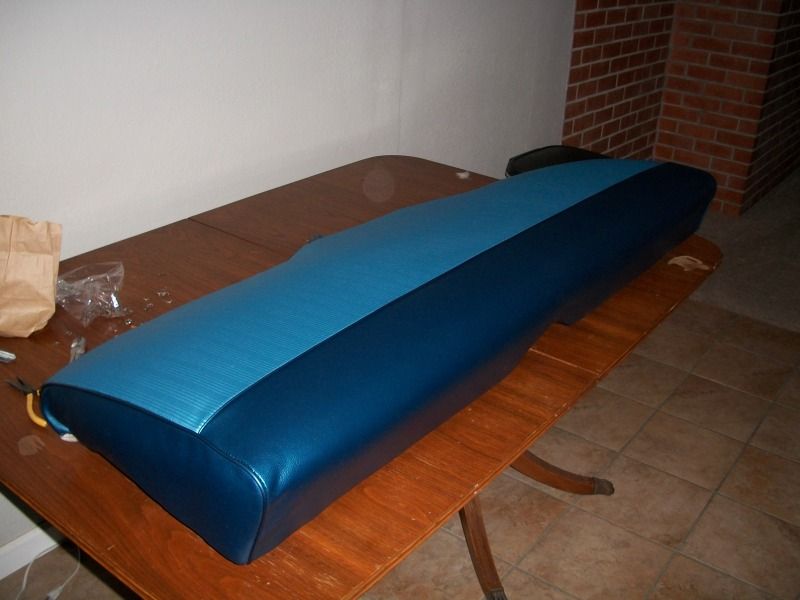

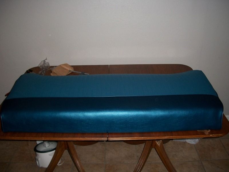

I just took the old hog rings off and placed the new seat cover in the exact same spot (turn the cover inside out). You can see where the vinyl cords have sort of indented the foam. Just lay the new cords in the same indents and then fold down the outsides to wrap around the seat. Pull things tight with your hands and make sure you are happy with where it is sitting. Start your first hog ring in the middle of the back of the seat and equally work your way out. I did the back side and then the front side. Then I really tightened down the sides of the seat to get the wrinkles out of the top. As you can see it's not perfect but it's good enough with old foam. I made sure the wrinkles I left would be either hidden on the sides or at the very back of the seat where the top will cover them. In a perfect world I would have bought new foam because this was the most worn of the foam in the car. I just didn't have the $150 or so to spend on high density foam.

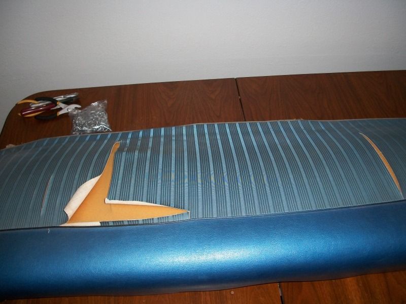

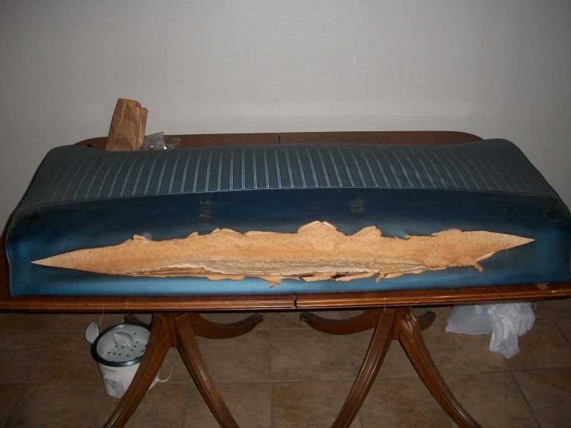

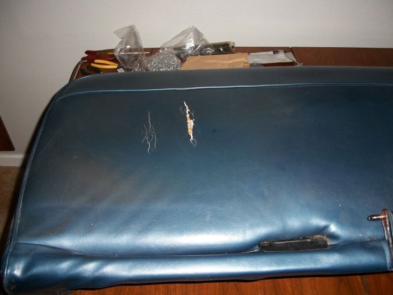

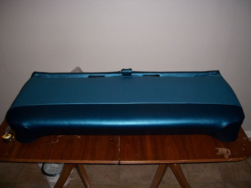

Then I did the top of the back seat. As you can see, the top of it was tore up big time. Most of the foam was there but some of the top layer had blown away with the windows rolled down. I bought some cheap cotton batting from wal mart and cut it to size and placed it up there to "fill" out the missing layer.

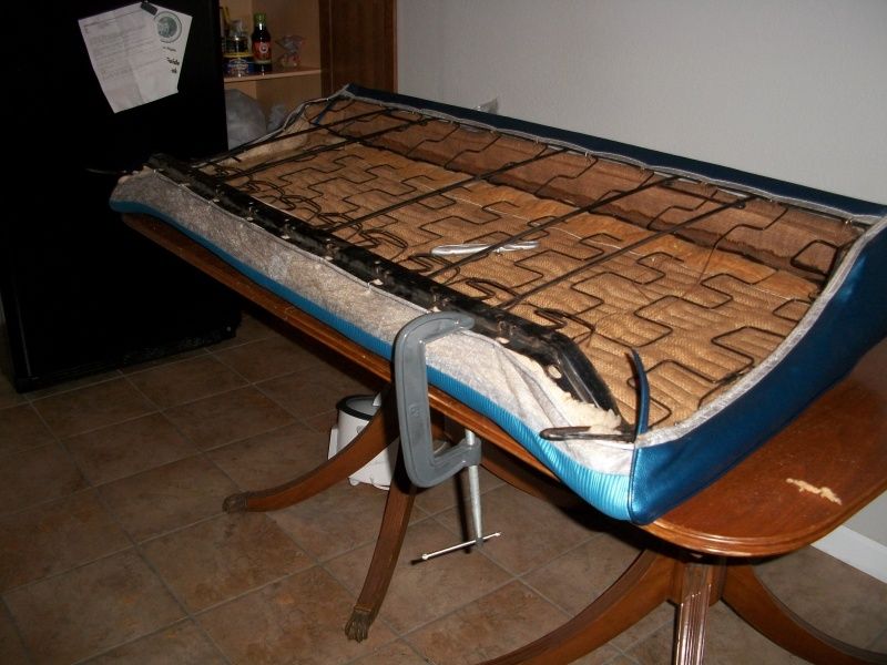

If you don't have a helper, a large C clamp works for compressing the seat springs so you can get the vinyl pulled tight enough. Again, start at the back in the middle and hog ring out. Then the front. Then the sides. Flip the seat over multiple times as you go to make sure you are getting the wrinkles out. They will start flatening out as you apply more hog rings. If you aren't happy with the way the cover is positioned after you've gone a couple sides, cut the hog rings off and reposition the seat and do it again. It's better to take the 20 minutes to fix it, than to get it in the car and have to pull it out and restart the whole process over.
This one came out real nice. Remember there are wires in the vinyl called "listing wires". They are used to hog ring around so you don't tear the vinyl over time. Check your old covers for the wires and remove them and give them a good cleaning so you can reuse them. If you can't reuse them, some medium gauged bailing wire should work just fine.

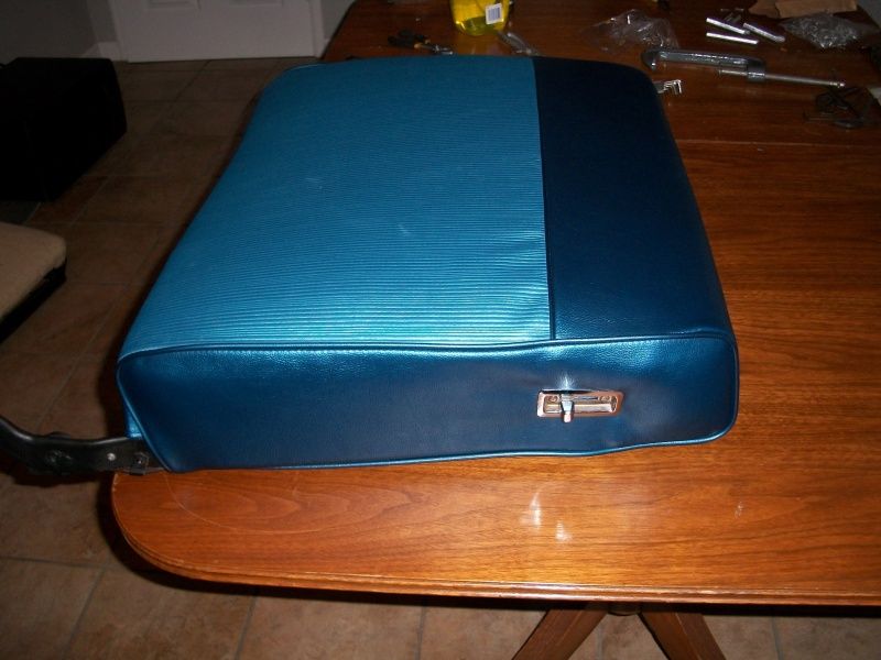

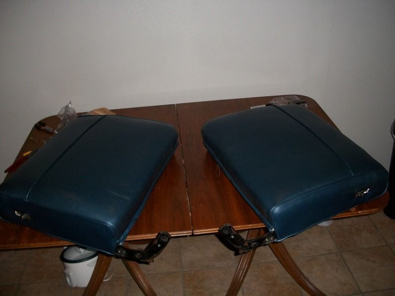

The front seat was recovered about 12 years ago with regular custom vinyl. These are the backs.
The hardware and trim had me nervous because you only get one chance to cut for it.
This was my least favorite of the covers I did. I could not for the life of me get those wrinkles out no matter what. The flash from the camera makes them look about 5x worse than they do in person though. The other back rest turned out perfect. These back rests are the easiest covers to do. Watch the Legendary video and they show you to turn the cover halfway inside out. Then press the cover on to the seat as tight as it'll go and slowly roll/slide it down until it's tight. Just keep an eye so the cover doesn't try and "twist" itself on the frame and get crooked. Roll it down evenly to avoid this. Then use your armpit to compress the seat springs and start hog ringing from the inside out.
Give the chrome latch a good cleaning. The little knob on the handle is removed with a small allen wrench. Be careful because it's tough to tell if you have the right size. You really have to jiggle it in there to make sure you're in the screw. Cut a tiny x over the latch handle as it's poking at the vinyl once you get the seat on. Then fit the chrome trim around it and you can feel it sink into place. Get your screws in and then make a little slice down the center of the trim so the handle can move up and down freely.

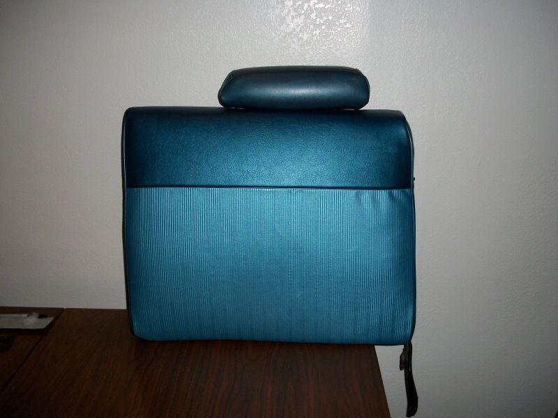

Same deal with the head rest trim. Once you get the cover on, feel for the holes in the top and cut a little hole in them with a razor. Then make the hole slightly bigger and bigger until it's big enough for the head rest. Remember you can always go bigger but if you cut too much then you're SOL. After that, the trim pieces will kind of pop into place and the screw holes will be lined up. Just make sure you get them right side up.
The front bottom seat is the toughest to do. You'll most likely need a helper for this one.
There are seat belt holes that will have to be cut out later. They are fairly nerve racking to do because they aren't as cut and try as the trim on the back rests. Just measure where the holes are at and take your time when putting the cover on. Make sure you have room in between the seat springs to install them before cutting. Feel through the vinyl to make sure you know where you're at.

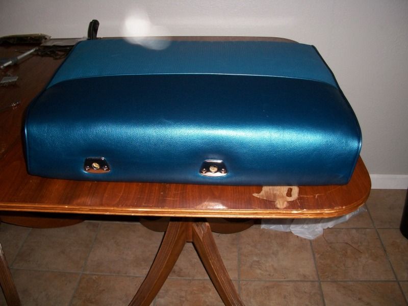

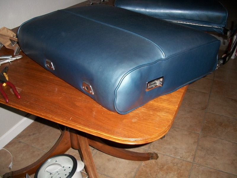

Bottom turned out much better than expected.
See near the back of the seat where it looks like the vinyl is pulled down tightly before going over the back hump? Before you put the cover on, you'll see where it has an extra layer underneath where you're supposed to place a listing wire. With the seat turned over, have a helper pull up on the listing wire with pliers so you can hog ring it to the springs. Start in the middle and work your way out with the hog rings and it'll be real tight. Then start at the back and work your way out and then go to the front and work your way out. At this point you will still have some wrinkles in the seat but they should go away when you tighten down the sides. This is where those angled hog ring pliers come in handy. Use pliers or have a partner use them to pull the vinyl up because the hooks that you hog ring to are further into the seat frame than the front or back sides. After that, cut little x's over the posts sticking out the sides and push them through. Then clean up the holes so they look nice. After that cut out your seat belt holes as explained above and you're done.

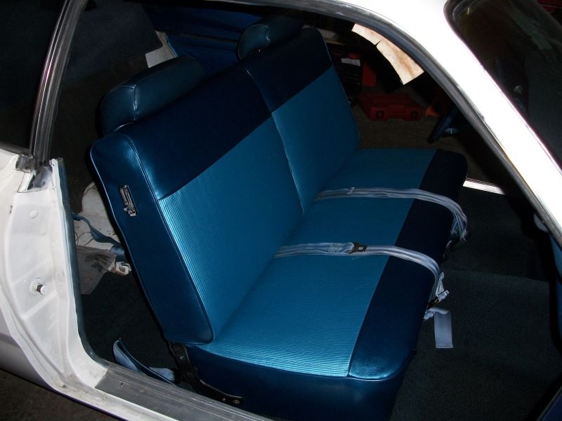

Not too bad for a first timer who's never messed with covers before. I'll put the back seat in once I get the interior trim painted. It's just tough finding B7 blue paint. Seems like no one carries anything that matches it. I had to install the front seat because it's my daily driver and I need to get back on the road.
