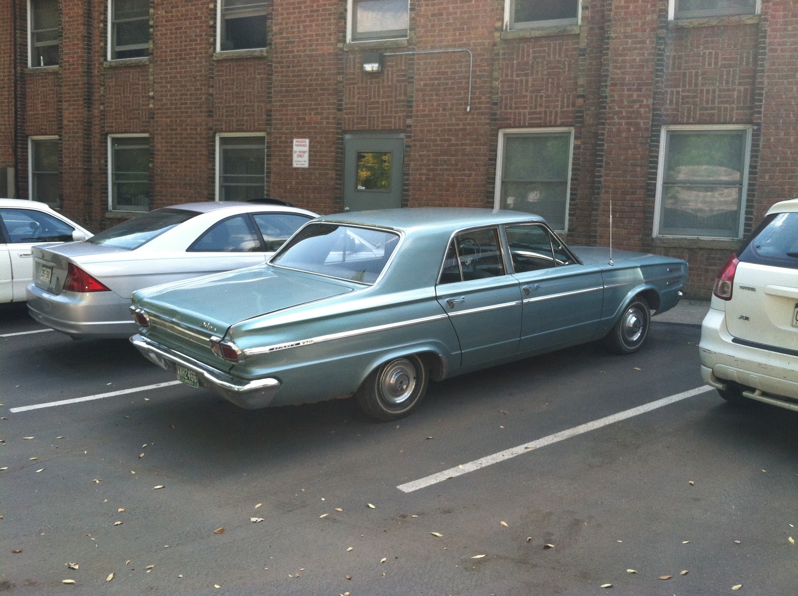

First, here is a picture of her. (hope the picture works)
There is a little rust on both sides of the rear quarter panels but other than that and some dents it not in too bad shape. I got a steal on the car so I don't feel too bad about modifying it. First thing I wanted to do was put a new stereo system in it (nothing ridiculous!) but the guy at Best Buy asked me why I would rip apart a classic with a nice interior... It got me thinking about what I should/shouldn't do.

Looks like a great car. Some partial answers to your questions:
I would find a stereo deck from the 80s-90s to fit in the stock opening, OR mount a later unit inside your glovebox or under the dash and use a remote. 6x9s will fit in the rear deck openings (up to 3!). I am personally looking for something that would plug into an ipod that is just a little amplifier/receiver unit that would run 6X9s. I have a CD changer in the trunk of my 68 Dart that has worked well for 12+ yrs that runs through a 1989 vintage Radio Shack tape deck...
OEM radiators are available for around $200-300, or $400 or so for a really nice aluminum one. You can also likely fix the original by finding a dedicated radiator specialty shop.
Trim parts: Go through Ebay or this site "parts wanted." Used is the only way for parts like that.
Wheels: 5X4.0" yep. You might still find 14X7s with 4 to 4.5" backspacing, but 14" tires are getting scarce. For my money and peace of mind, I would convert to 5X4.5" bolt circle in front with a disc brake kit, and rear with a later 7.25" axle, or Ford 8" axle from a Granada or Maverick (5 lug units). Then you can go to 15" or 16" or even 17" wheels and tires of many, many variants. This is huge can of worms, so maybe wait a while.
