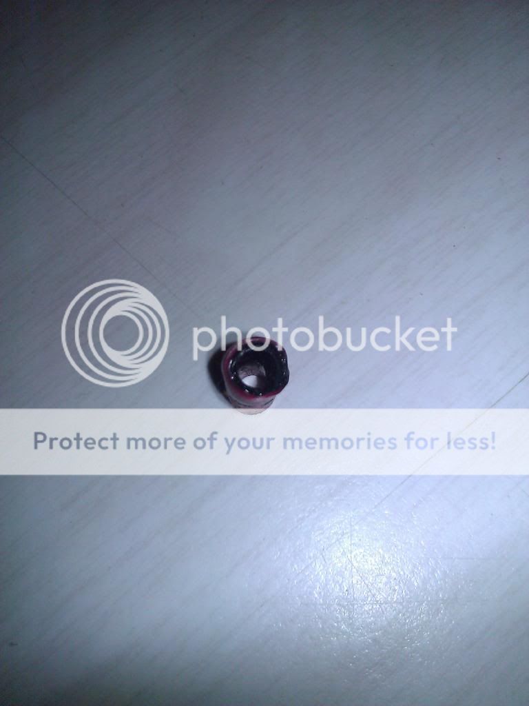

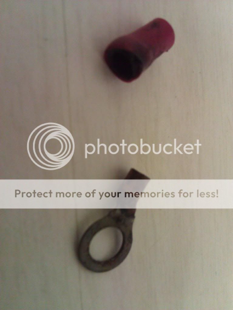

Well anyway, I went to check the connections on the alternator and I found that one of the connections from the voltage regulator was broken.
Ok, so not a big deal after all. I pull it off and went to put a new one on and noticed this.
It looks like it got melted... Only the tan color wire melted, the green one was perfectly fine and still connected.
I'm wondering if this is a sign of deeper issues (like the alternator is too big for the voltage regulator wires) or if it was just a bad connection heating up (I hope :) )
