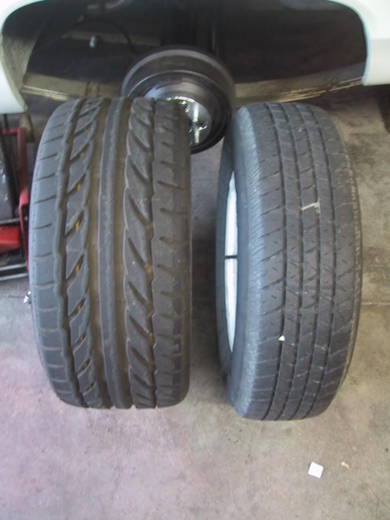

PostPosted: Sun Feb 10, 2013 10:03 am
Dare I ask what size street tires?
Probably not like the one on the left I would assume.

PostPosted: Sun Feb 10, 2013 3:17 pm
Josh,
I don't even know what size those street tires are but they're not very wide; maybe 5".
Bill
The tires I posted are a 255/40R17 and I believe a 195/75R14. Never mind the compound differences!
