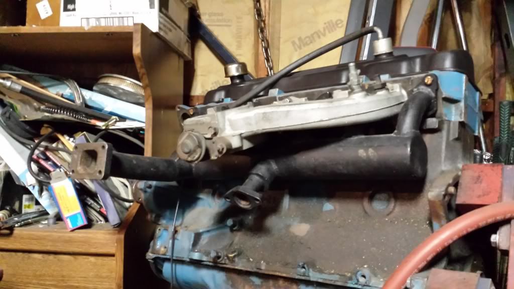

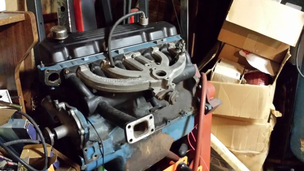

Dave you would do every well to Build some sort of turbo header for the Slant. I have a spare log style turbo manifold you could copy, I also have some 1/2 SS header flanges you could copy. I'm not far from you I'm in the Jackson area.

PostPosted: Sun Jun 30, 2013 5:59 pm
Joined: Tue Dec 07, 2010 5:07 pm
Posts: 277
quote="superdve"]If somebody in the Detroit area has an early car, we can look at it and see if we can work on something universal.[/quote]
Dave what did you come up with?
Here's some pics of the log on my next turbo motor.
http://i1109.photobucket.com/albums/h43 ... 203500.jpg
http://i1109.photobucket.com/albums/h43 ... 203444.jpg
Aaron
