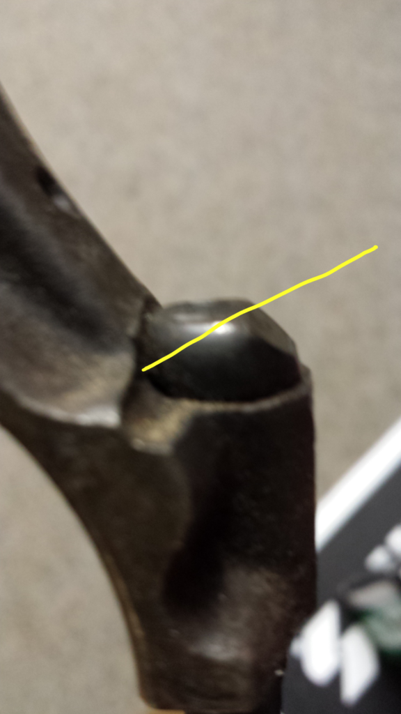

Ok this is a stock 225 rod. Where the yellow line is there is there is a small lip on the arp stud and with the factory ridge the way it is it rubs in the Aera of the yellow line and its enough to add a small angle on the stud and it toes the studs out.
Is this what your experiencing also Rick?

Yes Aaron that is what I am seeing. Mine toes the rod bolts inward also.
Rick

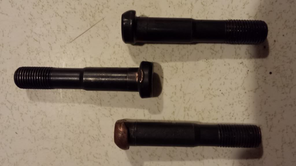

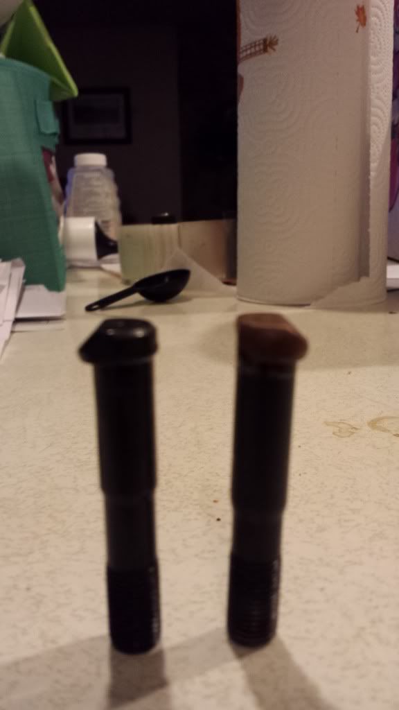

Left stud is the arp stud the right one is a stocker which is completely flat on one side
Bottom is stocker
Middle is a pic of arp stud with a witness mark
Top hopefully you can see the small ridge on the arp stud
