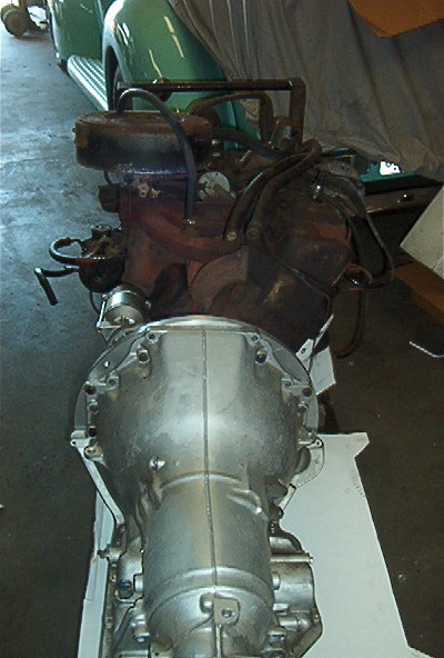

hey guys i have info coming from wilcap that they have an adapter for the slant six to a chevy 200R4, it comes with everything...
waiting on pics and price... hopefully today!
will update as soon as i know something...

here is a link to the post on FABO of the pic and email he sent me...
here ya go guys!
"Ed: We have done the Slant 6 to the Chevy auto but it has not been a popular adapter. Price is $650 with flexplate, hub spacer, fasteners, instructions and of course the plate. Uses the later SB Mopar starter Not included and needs to be modified slightly). Photo attached.
Thanks and spread the word."

PostPosted: Fri Aug 17, 2012 10:42 pm
Posts: 17671
That is great news! I called Wilcap a few months back and they said that others made this and that I should call around. I turned up nuttin back then and never called Wilcap back.
I am looking at using this trans on at least one upcoming swap.
Should we try to gauge interest for some sort of group buy? I am in for at least one, maybe two. The price may go down.
