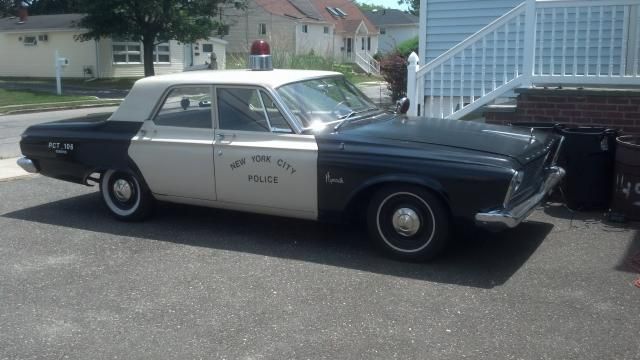

Here is a pic so everyone knows what I'm working with
As much as my wife wants me to I am not going to keep the cop car theme. Unless it get's tubbed and a big block lol

Lucky dog! However, be careful about driving that thing on the street. At least check your laws about impersonating a police officer. Where I live, I could get arrested if I drove a car that looked like a police car with the markings and lights on it.

From what I learned it has no state or county seal and I can't drive with the lights and siren on. Plus what department still uses these cars that someone could get confused.

I'm not saying the law makes sense, I am just saying that where I live you can get busted for even having a red or blue flashing light operating in your car. I don't know what the laws in your area are and it sounds like you know what you are doing. I was just trying to offer a friendly word of caution.

Was it actually a police car? There are collectors, even for the low-performance cars ... and the lights and sirens are worth something as well, if you choose to sell them.

No it was not an original police car. It's more of a tribute car. I did plan on selling off as much of the police stuff I can to fund other needs. I know I want/need to convert to at least a dual reservoir master cylinder. The single res master scares the hell out of me lol. Would love to put front disc on it too.

Beautiful! Has that Mayberry RFD look.
