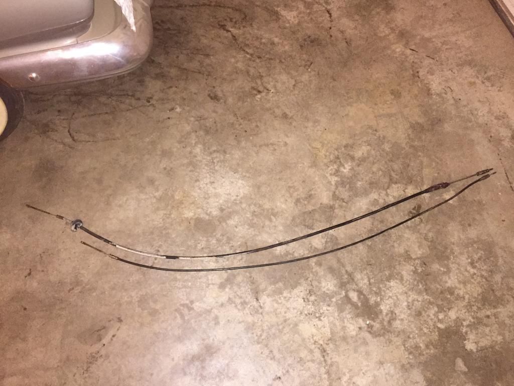

Finally got the Park Lock cable out of the 60.
CHRYSLER, you've GOT to be KIDDING ME!!!
The 1960 park lock cable is 6-9" LONGER than '62+. I wouldn't call that 'directly installable'. I will try but that shorter length may cause issues.
:evil:
'61 is probably same as '60 since the dash design is the same.

Looks like the original cable is coming in at between 66 1/8" and 66 1/2" tip to tip.
I could be wrong about the 61 being the same. From engine bay pics I've seen of 61 Valiants, the park lock cable is grouped together with other cables and wires and exits the firewall at a slightly lower location than the 60, which has a separate round hole, cut higher up on the firewall for just the park lock cable to exit.

A heads up that the shorter cable actually did install in the '60 without issue.
Worth noting there is no slack at all though. The original with it's longer length would allow the cable to snake through the firewall hole, down and clip into the under-floor clips easily while reaching the trans. The shorter cable doesn't have enough length to clip into place (it's a bit taut), but does reach end to end, and stays out of the way of the exhaust pipe (no more melted cable jackets please).
Success.
