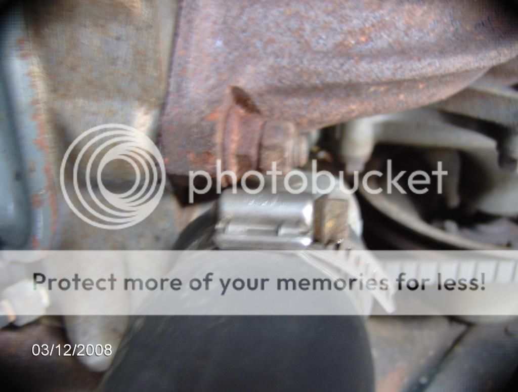

I noticed that my engine is missing the correct hardware to secure the manifold to the head. The deals that go on the ends that allow it to slide.
Truck runs great with no major issues so of course I am apprehensive to screw with it.
This is a Jasper re-built engine, evidently whomever put it together knew that there was supposed to be some special hardware there cause they did make some small effort. This is the front closest to the rad Image

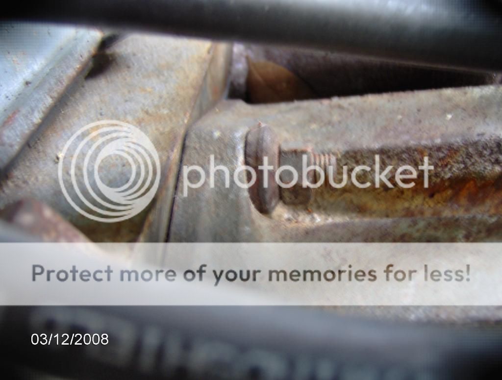

Here is closest to the firewall Image

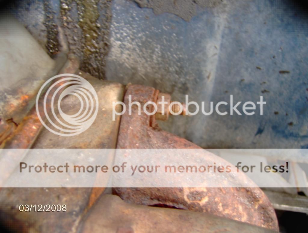

And this is the middle one which does look correct Image
I dont want to ask for problems so maybe I just need to address this, hopefully if I remove one nut at a time I wont have problems with the gasket leaking?
I do have what I believe is the correct hardware, I am making it a point to grab this sort of stuff at the salvage yards when I see a slant six.
