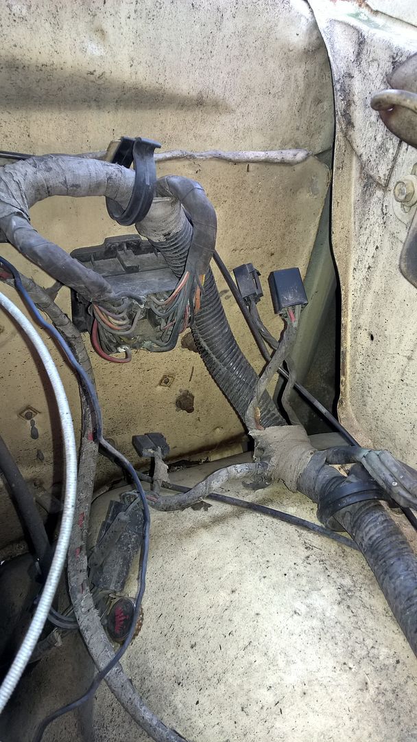

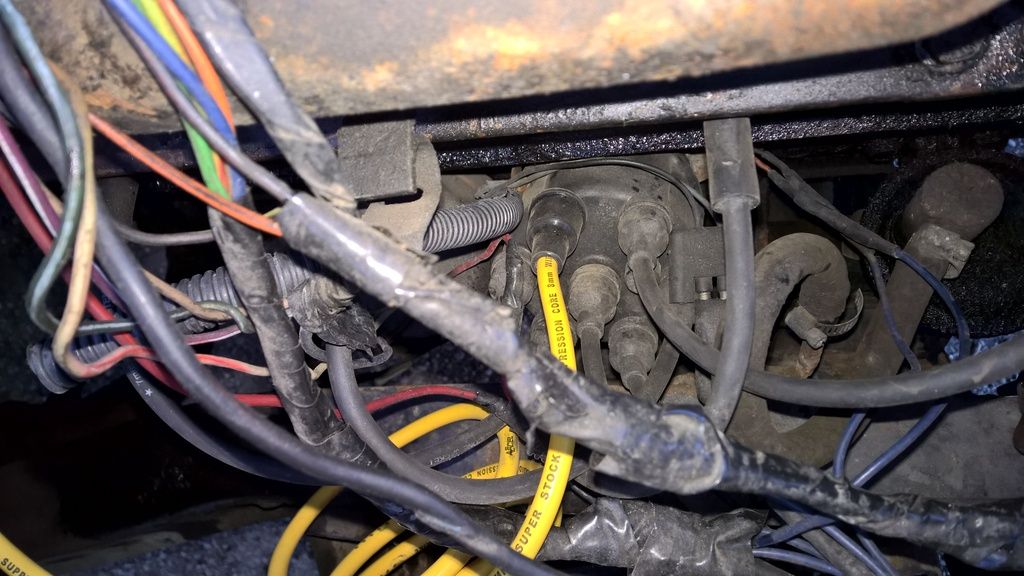

I took some picks. This wiring is some hillbilly engineering from what I can tell. Looks like it may have had the HEI at one point. There's a couple of vacuum lines leading to nowhere. One is off the charcoal can. SEVERAL 2,3,4,5 prong electrical wiring connectors in limbo. I'll get a service manual, but I have a feeling, there have been some heavy mods/de-evolution under the hood.

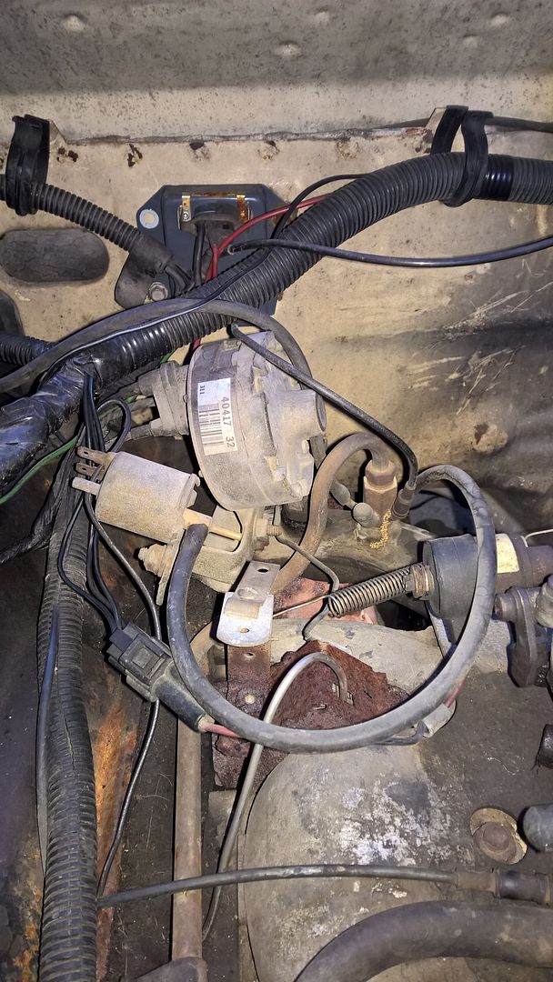

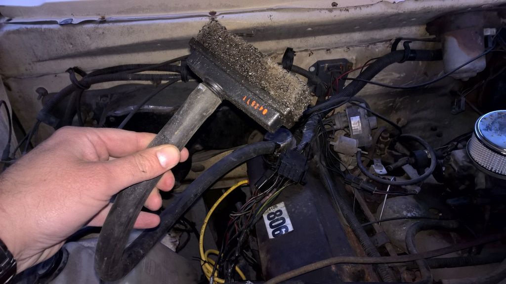

Sponge on the PVC hose? Is this normal? Doesn't seem to be a connection on the carb or intake.

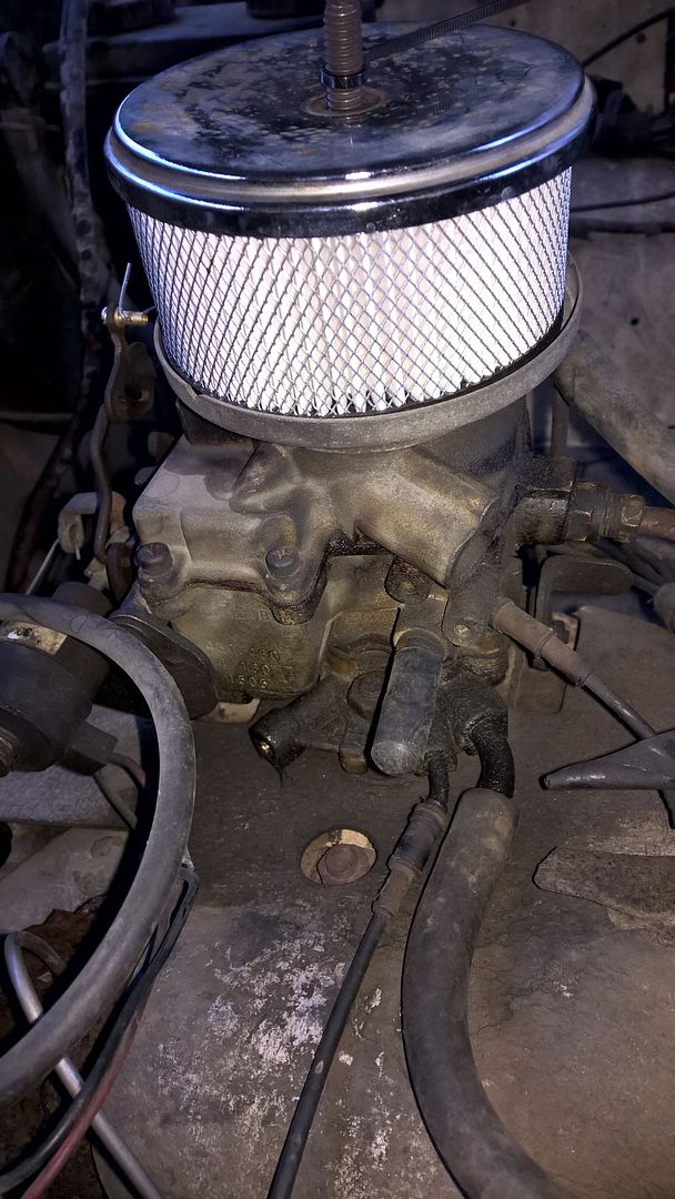

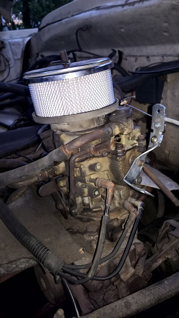

Is this the stock carb?

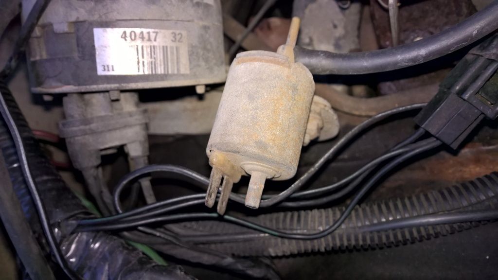

This looks important...
An example of the disconnected wiring

It looks like somebody tried to remove the lean burn system, but didn't finish the process.
Reed is going to be able to help you more with this one, and I'm sure he'll pop up.
To put the lean burn back into working order may be a tall order depending on what is left, and what still works from that subset. If the truck doesn't need to pass emissions testing, then you may find it easier to complete the conversion to earlier components. Does the distributor have vacuum advance capability or is it fixed?
A search of slantsix.org will outline many of the parts needed to convert to the 74-77 or so distributor, HEI ignition, and an earlier carburetor that won't need the computer. I didn't see a photo of the computer, so can only assume it isn't present.

That air intake hose terminated with foam looks to be a remnant of PCV system which probably attached to factory air cleaner. Factory air cleaner would have had provision for ducting cool air from out side engine compartment, and a vacuum actuated flapper in its snorkel to provide warmed air during cold starts.
Yup there has been some fine Budweiser Engineering performed on your Li'll Buttercup, some of which was amputation of her Lean Burn bits.

I am working right now so I will have to go into more detail later, but at first glance it appears that some has done some major hacking in the engine compartment.
From the pictures, it appears that the carb is a Holley 1945, which could be original The carb has had the factory automatic choke disabled (but all parts appear to be present, just mangled out of the way) and a manual choke installed.
The PCV hose should connect to the largest port on the base of the carb. it looks like the EGR system has been tampered with. That crankcase breather with the "sponge" o the end used to connect to the factory air cleaner. your air cleaner is not factory equipment. The SMOG pump appears to actually still be hooked up, but the drive belt has been removed. If the pump still turns freely, then yes, you should hook it back up. However, chances are that the lack of air injection into the front catalytic converter has lead to that converter failing internally and becoming clogged. You probably also have a second converter that has failed and clogged.
My preliminary diagnosis is that some poor soul who didn't really know what he or she was doing tried to remove the lean burn system and did a poor job of it. The good news is that your carb might be able to be used without a lean burn computer. However, it may not have the correct port for a non-lean burn distributor. Can you post a picture of your distributor?

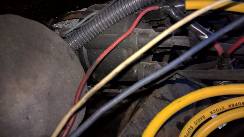

Here is the distributor. The best I can do with the engine still hot.

I don't see a vacuum can on right side of distributor, making it a Lean Burn computer controlled advance. That distributor has no provision for fuel saving vacuum advance.
Plan on getting an electronic distributor c. 1973-80 or so truck, in other words from a non lean burn, non points/condenser equipped truck as first choice. Like equipped car is another source, but will likely need some recurving to play well with truck's rolling brick profile.

WJAJR nailed it. That is definitely a lean-burn distributor. This means that if your carb is the original carb to the truck it may not have the correct vacuum port to work with a standard distributor that uses vacuum advance.
My recommendation is do the HEI ignition swap and carefully verify that the carb has the correct vacuum port for the distributor vacuum advance. You may also need to install a different carb.

That distributor, if it's a Lean Burn, is all jacked up for the application. I swapped mine for one from a 73 Scamp and it was a night and day difference. That carb isn't necessarily bad, but it isn't good either. a Holley 1920 is what I swapped to for a few years.
as for your wiring.... have fun with that!

If you have the 1945 carb, then you have the right one already (non computer controlled).
Not necessarily. Chrysler used some 1945 carbs that had no ported vacuum nipple for use with a distributor. The carbs were 1945 carbs but they had a full time vacuum source for use with a lean burn system that only controlled the ignition.
