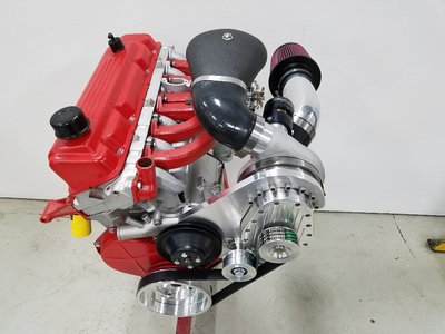

PostPosted: Wed Jan 03, 2018 8:09 am
Joined: Wed Nov 15, 2017 6:36 am
Posts: 1
We have a nice and simple package for the slants. Dr. Dodge is doing a book on setting one up for boost with our setup. Should be out soon.
Torqstorm
