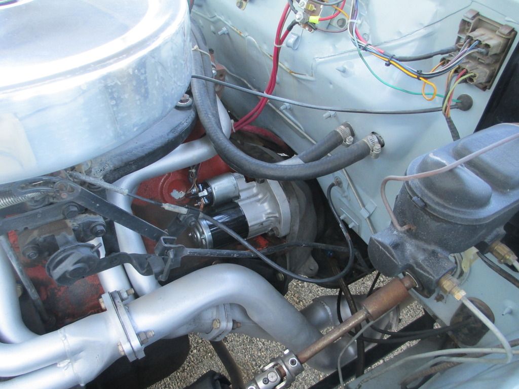

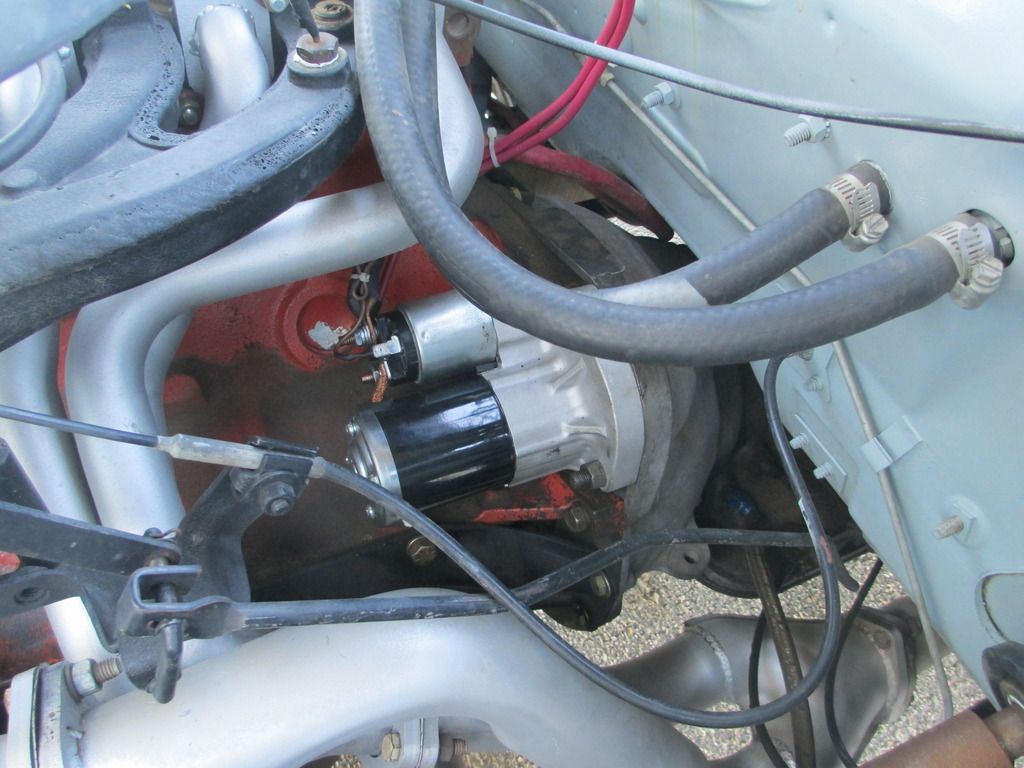

So we've had one of the "mini" Ram Hemi Starters sitting around the shop since folks started figuring out what they fit on and we test fit it on a few of our shop cars. Seems that it's a direct bolt in for the slant after drilling out the threaded hole to 9/16. And WOW what a starter it is! Previously the car had a standard "coffee can" type and took a couple revolutions to get up to speed, and then the car would light. On cooler mornings, I would have to roll the engine over 5 times, let the starter "spin down" then she would fire after 3-5 cranks on the second go. Just got used to it after 7 years. Not this little bad boy. On cold start, between 1-2 revolutions, she fires, and yesterday running errands, she would fire at the flick of the key. This car sees daily driving, so if it goes in the $#!+ I'll post about it, however I HIGHLY encourage this "upgrade" for now. Still kinda need to get used to the sound of it, definitely doesn't sound like a Mopar starter.
Slant on folks!
