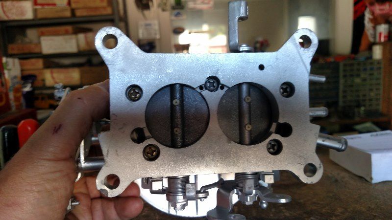

I went to a local carb rebuilder and asked if he ever saw any 2305's he said yes and he had one on the shelf that he rebuilt for a guy a couple of years ago and the guy never came back to pick it up. So I bought it. He is gonna go back through it to freshen it up, let me pick thru his 2 barrel adapters, and glass bead it and clear coat it all for $180. it is a 80120 350 cfm and will go on my offy 4bbl. manifold.

I am thinking of mounting mine sideways. For 2 reasons one for linkage to be orientated in a straight shot. 2 to align the throttle plates with the outer part of the offy opening. When the carb is in the center part of the manifold is directly below the opening.

[img][img]http://i1376.photobucket.com/albums/ah7/JohnnyDees/2016-07-06%20001%20004%20450x800_zpspjbc57ib.jpg[/img][/img]
[img][img]http://i1376.photobucket.com/albums/ah7/JohnnyDees/2016-07-06%20001%20002%20450x800_zpsznhdqfve.jpg[/img][/img]
[img][img]http://i1376.photobucket.com/albums/ah7/JohnnyDees/2016-07-06%20001%20001%20450x800_zpsbwuakji6.jpg[/img][/img]
These are the pics from the above post.
