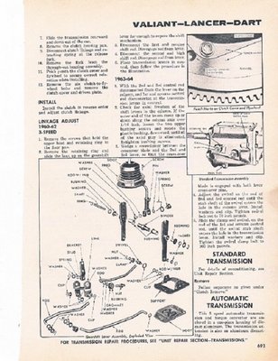

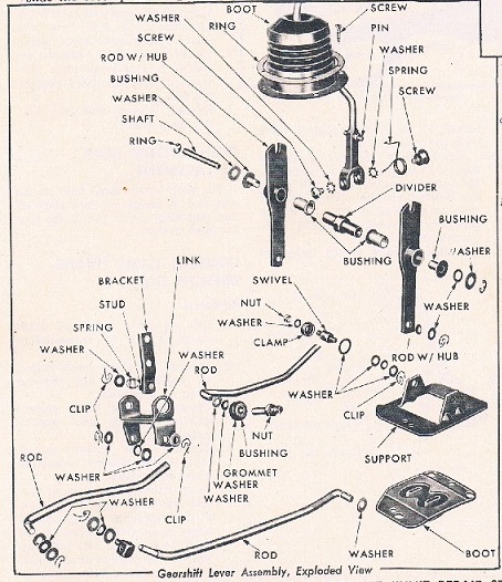

Hello to all fellow Moparniacs!
Im looking for any pics, diagrams showing parts and installation of the /6 3speed manual floorshift from the hump down to the rods including brackets, supports, ECT.
Thanks, Slowmo

From 1964 Chilton's Auto Repair Manual....
