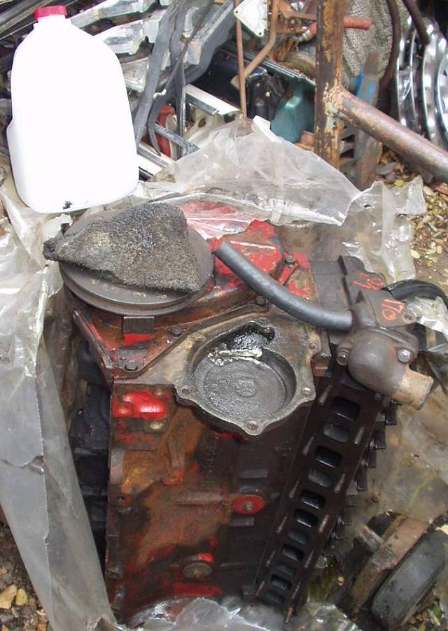

Keep in mind acid is not the only stuff that will take away large amounts of rust. There is Evapo-Rust, and there is also molasses (pics and info at the link). Both of those are a whole lot safer and easier to handle than acid, and molasses has the added advantages of being very inexpensive and very easy to dispose of without making a toxic waste dump of your local vicinity.

Diluted molasses. See Dan's link above to molasses.

…read the text and view the pictures at the link I posted.
