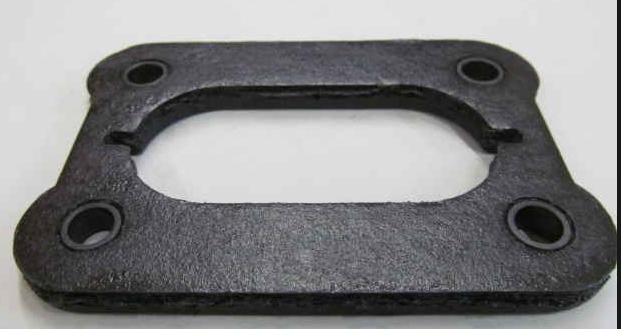

also it was delivered with a "thick" gasket with slots like this one

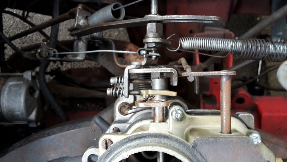

Can you post some pictures of your carburetor? Specifically the PCV hose fitting and a closeup of the idle speed and fast idle screws so we can see where they are set at hot idle?

last weekend i got time to play around with that carb thing
btw.. here is a pic showing the old idle screw setting you asked for
i started with seating the mixing screws and turning them out 2 full revs and setting the ignition to 10° BTDC
had to turn in the idle screw some turns to get it started und running with 740 -760 RPM - Vacuum was 15 in/hg.
then i started to adjust the mixing screws and ended up with 2 3/4 turns and 18 in/hg vacuum. That was the best i can get
test driving the truck it now has an idle about 500 RPM in D (e.g. waiting at a Stop light) but it´s not so shaky anymore like before with the nearly the same RPM. Overall it feels a bit more sluggish compared to the setting with the more advanced idle
maybe i will try to give it a bit more advance like 12 or 14 degrees
