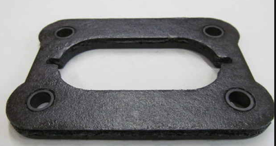

also it was delivered with a "thick" gasket with slots like this one
