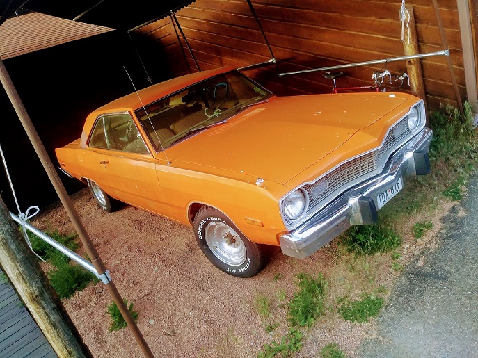

pics of your swinger?
https://tinyurl.com/yynpj4v2
PostPosted: Thu Jun 21, 2018 10:40 am
Joined: Thu Mar 22, 2018 9:52 am
Posts: 7
Car Model: 1974 Dart Swinger
Sure! This is about all I have so far...
