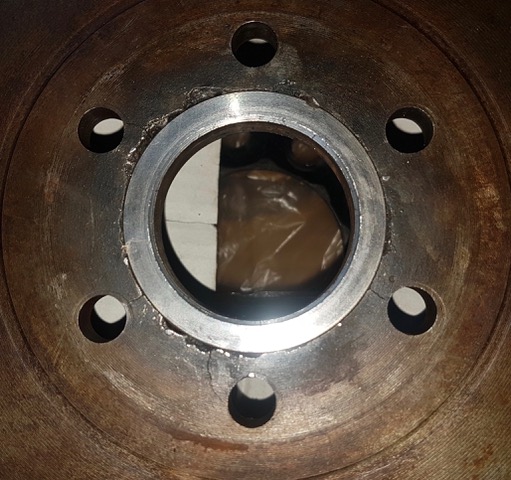

Hi just remove my clutch and flywheel to replace pilot bearing and noticed cracks in the flywheel near all bolt holes.
As well as what looks like a custom bushing from a previous owner.
Should I be concerned and purchase a new flywheel?
Cheers

It looks to me like someone adapted a late (68 and newer) flywheel to an early (67 and older) engine. The early flywheels, and flexplates (auto) are getting hard to find. I would be concerned about those cracks. I would try to find a early flywheel.

There's no way I'd use that f/w. Personally, I'd go to an OZ steel one anyway. Pricey, but can be had to fit, and are new steel rather than old cast iron.
I actually did that cobble once, but welded the "adapter" in place. "Interesting" weld, but no problems.

Since you don't have anything to lose, grind the cracks down to see if they stop.
Then decide what to do.
I also would remove the pressed in ring and chamfer the hole so no crack could propagate from there.

The cracks are visible from both sides emsvitil so guess I've got a good paper weight.
Thanks for the link Old6rodder. I have already called them and they are looking into it for me. I wasn't aware there's are called Oz Steel.
As this is for a truck D100 it currently has a 172 tooth fly wheel and so they are looking into a custom one for me to suit my starter.

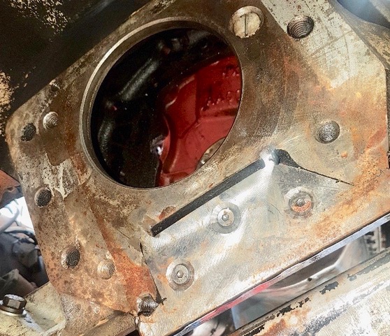

I'd like to see a picture of the adapter you have of how that transmission bolts to your bellhousing, if you have a moment to
take a picture of it.
I'd be much appreciative.

The previous owner did all the work.
from what i can gather its a 1961-1968 DODGE TRUCK HYDRAULIC BELL HOUSING 2235714-1 318 LA318 POLY SLANT SIX.
This looks to be all the modification to the bellhousing.
He has drilled and tapped 2 holes for the bottom of the gearbox to mount to. Possibly had to do the top 2 as well. There's a custom cross member under the gearbox as well .

1. I would toss that FW asap.
2. My guess is, since the cracks are on the inner diameter of the FW, (lower centrifugal forces?) they may not be of huge concern in normal use.
3. I suspect you will never see a FW with similar cracks from the outside edge, radiating inward, as it would have already failed. others can chime in.
4. Did i mention to toss the FW? :lol:
