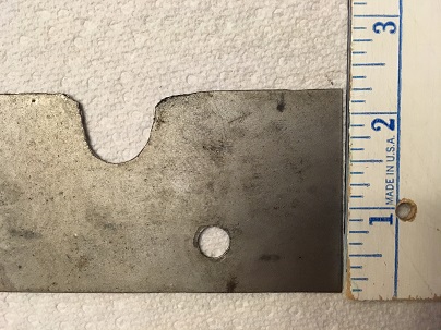

Does anyone have access to a crank scraper that is out of the engine?
If so Can you provide the measurement in between the arrows in the picture:
Also a measurement from pan rail edge to the Bolt hole center would be good too.
I have just installed mine and forgot to take these measurements.
Additionally if you take a picture of said part a ruler in the shot close to the edge that can help with my project.
Many thanks!

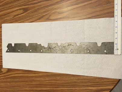

PostPosted: Wed May 02, 2018 7:40 pm
Posts: 3857
if Mike J had two patterns, then yes I have both of them
this is the one that looks like what Greg has in the photo.
Greg, if this is not close enough of a measurement let me know and I will put a caliper on it.
PostPosted: Thu May 03, 2018 4:26 am
Posts: 10251
Many thanks John, Rob!
