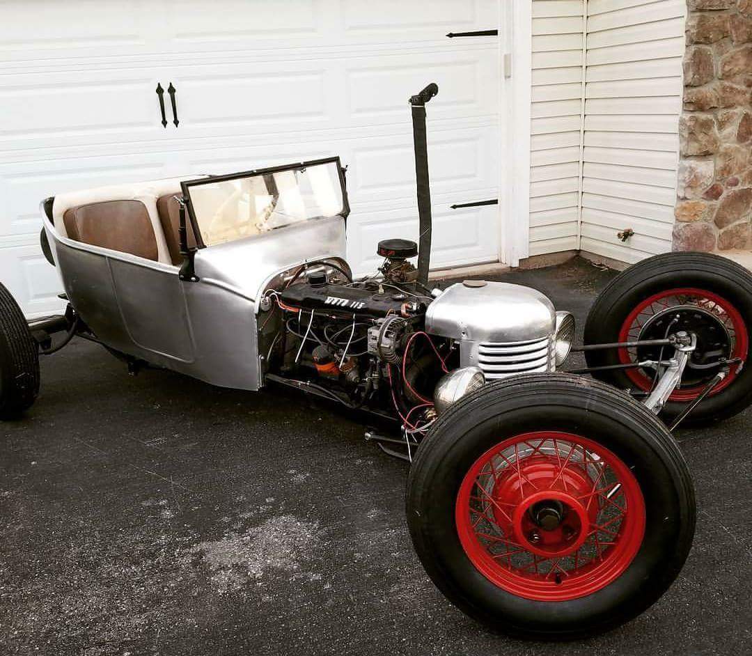

Here is the best photo i have right now. I am planning on running Dutra duals and run the exhaust along the drivers side of the car.

Cool ride, man! I bet that's a real attention-getter!
Welcome! You'll find that it's a good place to be.

Very cool! Sounds like a good plan w/exhaust. Hope you can join us at Mason Dixon Dragway in October, even if you just want to come and hang out and meet everyone.
