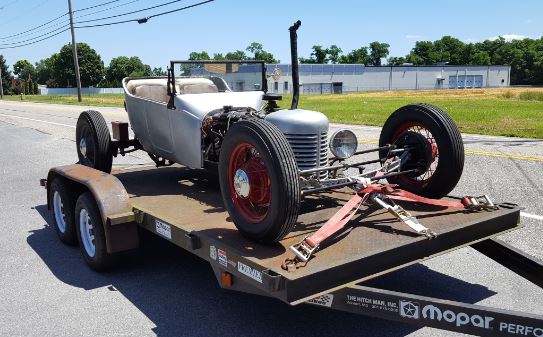

Its a roadster hot rod and only weighs around 1500lbs so hopefully it will be a fun ride.

Hmmmm. A '29 Dodge body with a slant. I think you're going to be disappointed, as I suspect it's going to come in closer to 2000 pounds, if not more. I built a slant powered, glass-bodied T that ended up being 2100, without my fat backside in it.

Disappointed I think more surprised. My dad has a 1937 Austin Seven with an original full steel body, slicks, custom front frame and a sbc and it weighs 1800lbs. I'm not aiming to have a race car just a fun cruiser. I'm riding a 40+ year old Honda motorcycle around and have just ass much fun if not more than the guys on the modern crotch rockets.

I would like to see a picture of the roadster!!
 Post subject: Re: engine upgrade plan
PostPosted: Wed Jul 18, 2018 9:21 pm
This thread....
http://www.slantsix.org/forum/viewtopic ... 20&t=62603
PostPosted: Thu Jul 19, 2018 7:32 am
Posts: 172
Location: Southern MD
Here is another one. A lot of the engine mods will probably wait till winter. The plan now is to get some seats in it, fix some trans leaks, add some rear shocks and run the exhaust along the drivers side. Then drive it around and have fun

Sweet hot rod man!
