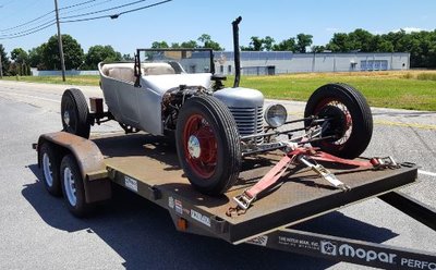

I just saw the picture of the car. Neat! But it looks like you have a hydraulic cam engine so you cannot use the Comp 264 or Oregon 819. Oregon Cam Grinding does hydraulic cams naturally.

Its a roadster hot rod and only weighs around 1500lbs so hopefully it will be a fun ride.

Hmmmm. A '29 Dodge body with a slant. I think you're going to be disappointed, as I suspect it's going to come in closer to 2000 pounds, if not more. I built a slant powered, glass-bodied T that ended up being 2100, without my fat backside in it.

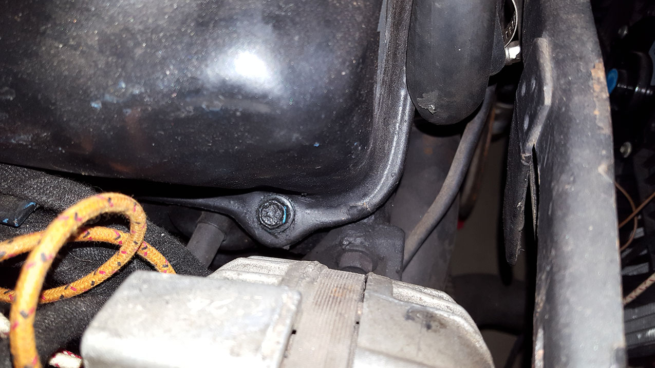

x2 on Josh's recommendation... the picture looks like the head and valve cover are the 1981-1987 type because the cover has a "jog" in it...
You can pull the oil fill cap and see if the rockers have adjuster screws or not... that will determine if it's a mech cam or hydro cam...
(I would worry a bit if you got a frankenstein that was a 1969 block, a 1981 head and cover, but with the 1969 rocker assembly...)

Disappointed I think more surprised. My dad has a 1937 Austin Seven with an original full steel body, slicks, custom front frame and a sbc and it weighs 1800lbs. I'm not aiming to have a race car just a fun cruiser. I'm riding a 40+ year old Honda motorcycle around and have just ass much fun if not more than the guys on the modern crotch rockets.
I couldn't get the valve cover off to look at the head casting numbers but it does have what looks like adjustable rockers. My phone takes too big of photos to add one. Could it just be a later valve cover?
No, that valve cover only bolts to the 1981-1987 head, the job in the pattern of the cover would leave a massive gap and oil leak on 1960-1980 heads.

Here is the front corner behind the alternator...
after reading this post http://www.slantsix.org/forum/viewtopic ... 3&start=15
I think it is a 60-80 head

Good deal, the close up is much better than the overall picture that is a bit misleading... that makes it easier, and 99.9% of being a
mechanical camshaft that can be reground....

I would like to see a picture of the roadster!!
Author:  DusterIdiot [ Wed Jul 18, 2018 9:21 pm ]
Post subject:  Re: engine upgrade plan
This thread....
http://www.slantsix.org/forum/viewtopic ... 20&t=62603
Author:  Thebearded1 [ Thu Jul 19, 2018 7:32 am ]
Here is another one. A lot of the engine mods will probably wait till winter. The plan now is to get some seats in it, fix some trans leaks, add some rear shocks and run the exhaust along the drivers side. Then drive it around and have fun
