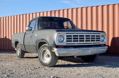

This is my 1975 D100 soon after I bought it, on Black Friday, 2008.
Until that day I had zero experience with Slant 6s. Not long after that I found this forum and that all changed. I was on here lurking for a while before finally signing up in 2011.

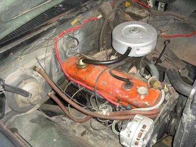

One more for now. Here's the \6 from Jan 2009.

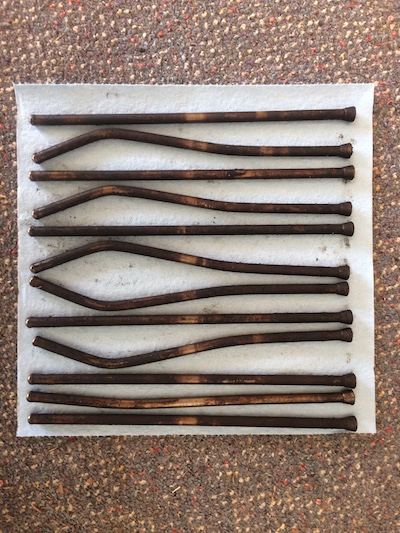

Finally, January 2017 I jumped back in and got it running. this is when the bad gas lesson was learned.
We got this fixed with new push rods, a clean gas tank and a rebuilt carb.
Not long after that the D100 was back at home with me where I could spend more time on it.

Yikes! That's a lot of bent push rods! Nice looking truck though. I have an '84 D100 and had an '86 W150, and an '83 van, all slant powered. Plenty of power on flat land or down hill.

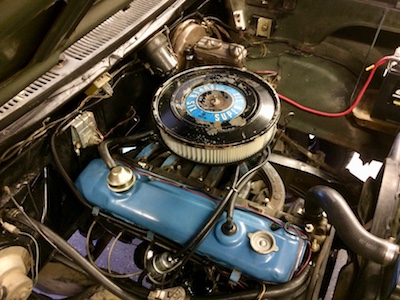

Last year I began searching and found a really nice Super Six manifold, and a very good rebuild candidate Motorcraft 2150 carburetor (1.08") both from a nearby salvage yard.
I sent my distributor off to DusterIdiot for a re-curve, rebuilt the carburetor and began assembling pieces to upgrade to the two barrel set up. I realized I needed a new timing chain due to the 12 degrees of slop in the distributor/crankshaft connection. I verified the damper was in good shape by rotating the crank both directions against a piston stop and getting the same measurement on both before and after TDC. After reading posts on here about sealing up the oil pan and rear seal, I decided the best way for me was to complete that with the engine out of the truck. One weekend, my son and I pulled the engine, swapped the timing gears and chain, installed new pan gasket and rear seal, upgrade to Super Six with the Motorcraft carburetor, universal throttle and kick-down cables.
That was a year ago. Man, how time flies.

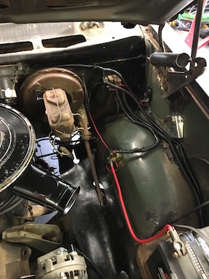

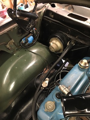

Well, this weekend I set out to finally upgrade to HEI. I've been accumulating all the necessary pieces for quite a while. I don't know what took so long, just never took the time to actually do it.
I got a GM coil/HEI bracket off a big block powered Suburban, used the heat sink and modified the coil mount for the Ford E-core coil. These were mounted on the right side inner fender.
I went with the relay for getting full voltage right off the starter relay. Just for irony's sake, I mounted the relay in the spot formerly occupied by the ballast resistor. :lol:
I'm really happy with the finished product. I still have a little tuning to do, but the difference is worth the effort, in my opinion.

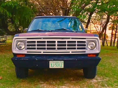

This being my 100th post on the forum, I thought I should post pic to celebrate!
Thanks again to everybody for sharing your knowledge and experience.

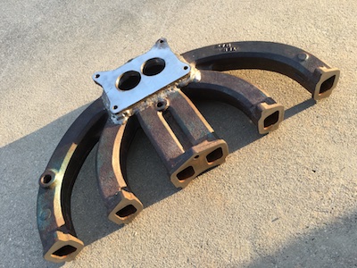

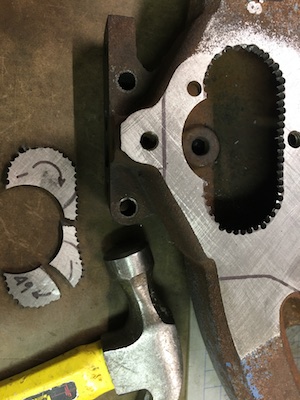

I posted the install of my parallel two barrel intake on the "What did you get done to your slant today?" thread. (http://www.slantsix.org/forum/viewtopic ... 03#p470103) This post covers the fabrication.
After reading about and seeing a few of the parallel two barrel manifolds, I figured "what the heck?" and decided to give it a try.
I already had a single barrel intake from a salvage yard and began grinding away at the carb mounting pad.
Once that was out of the way, I marked, drilled, and punched the top for the two barrel openings.

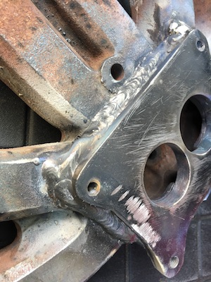

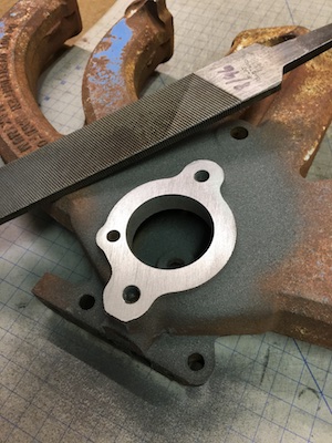

I had a friend cut me a new pad out of 1/2" steel and a local shop handled the welding.
The rest of the engine is in it's 40 year old natural state, so I left the manifold natural as well.

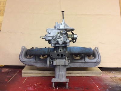

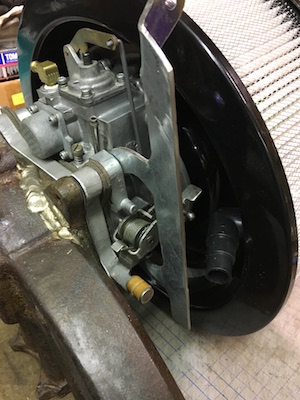

I'm running this manifold with a Motorcraft 2150 (287 cfm) carburetor and Summit throttle and kick down cables on a homemade carb-mounted bracket.

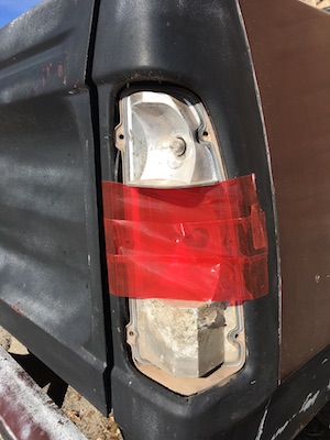

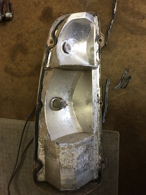

I drove the pickup to work last Friday. Sometime during the day I noticed that my right tail light was missing. :shock: Not sure what happened, no signs of damage, it's like the screws just fell out.
Luckily, the Napa store along my route had some of that temp repair tape. It was enough to get me home. Careful observers will notice this is before I borrowed a screw from the left side light to secure the lamp and complete the ground for proper operation.

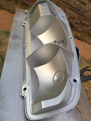

RockAuto had some nice replacement tail light lenses that arrived in just a few days and since I had some time off this week, I took the opportunity to refurbish the reflectors according to instructions in this post:
http://www.slantsix.org/forum/viewtopic ... lit=chrome
The reflectors were a little crusty before I got started
but they cleaned up pretty good. Just don't look too close at the "after" pic. :lol:

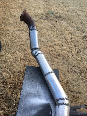

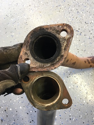

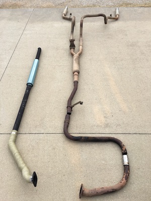

This week I also got around to doing the exhaust system upgrade that had been on the back burner for several months.
It started with a 2.25" headpipe stub that came with a Super Six manifold set that I picked up last year.

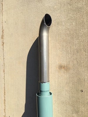

I watched some YouTube videos on how to do pie cuts and then went to town with my gasless MIG welder.
Thats a Smithy 2.25" glass pack that was recommended by Coconuteater64 and others. The sound is nice and mellow, with a little growl when I stand on it. Best of all, it *probably* won't disturb the neighbors. HAHA! :twisted:
The header wrap covers the pipe until it gets past the engine compartment. This serves two purposes; helps keeps the engine compartment temps down and conceals some ugly, yet functional welds! :lol:
And as you can see by the side-by-side comparison, this simple system counts for a considerable reduction in weight, too.
