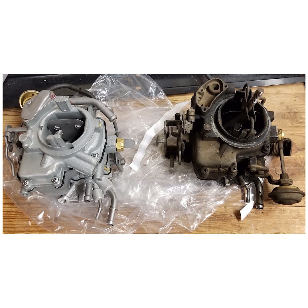

Trying to get ‘74 d100 up and running for daughter. I am having trouble getting the correct carb one of the screws has pulled out its treads. I ordered one it does not match what I have, looking for an I.D. I believe I have a 1920 and 1945

Looks like different years ,versions of 1945. What are the numbers on each carb ?

3751425
6725
0294
Is stamped on the one I took out the new rebuild has already been returned

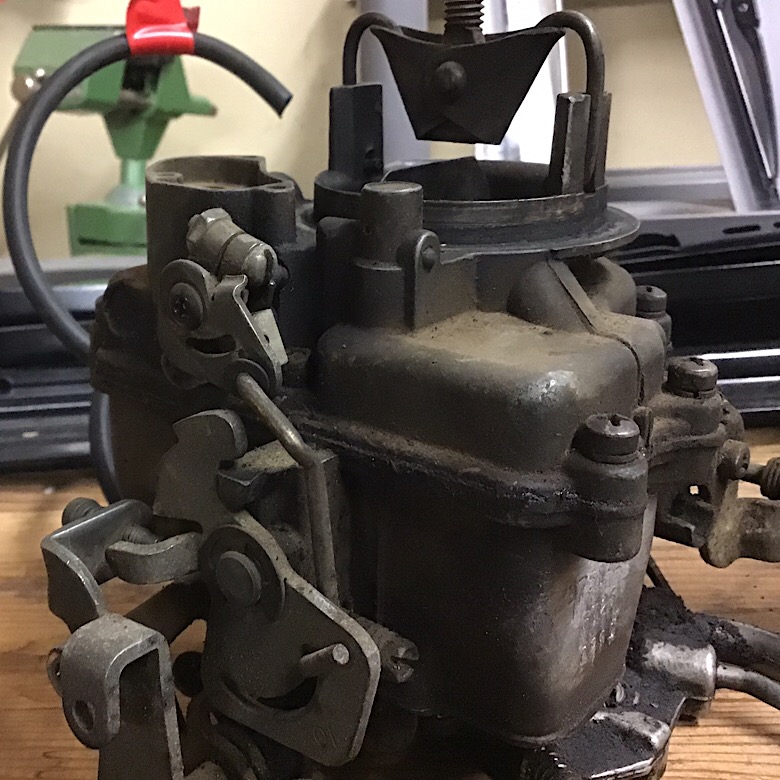

I found a picture of a Holley h1 1945 the looks the same and mine. The choke lever on mine has a screw at the end so my choke cable connector can slide on. I just can not find any info on 1945 carb versions.....

6725 is for 74 truck and stick shift trans California emissions

http://www.slantsix.org/forum/viewtopic.php?t=55801 info in this section
