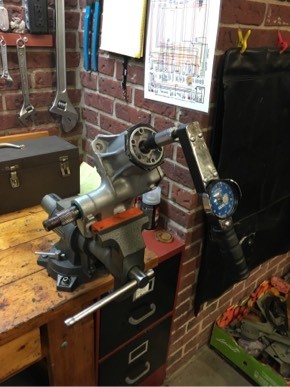

Prior to disassembly, I used my inch lb torque arm to measure the rotation of the complete assembly at the cross shaft.
FSM spec is 8 to 11 inch lbs across the high spot at the center. Here the reading were erratic the entire time, never less than
15 and would range up to 20 in flashes
I removed the cross shaft and measured just the worm shaft, for that the FSM says between 1 1/8 to 4 1/2 inch lbs, again the
readings were very erratic, the needle on the torque gauge was flashing high to low continuously.

I installed the worm shaft, using the large end adjustor was quickly able to get the torque to turn of 2 inch LB.
The reading were steady, it was the worn ball and races on the end that were causing the erratic readings.
I then installed the cross shaft, and with a few adjustments got a repeatable reading of 10 inch LB across the
center high spot. The rotation is very smooth.

File comment: setting the screw adjustor

PostPosted: Mon Mar 18, 2019 11:29 am
for the spanner wrench and the 4" locknut on the box itself
for the 4'' locknut I have a really large channel lock plier, probably opens to 6'', handled that lock nut easily
for the spanner, I made a tool, using a 18 inch length of 1x1 rectangular steel.
drilled two through holes in the steel that matched to the center to center distance of the hollow bosses on the adjustor
and put two 1/4 diameter by 2 inches long fully threaded bolts through the two holes.
Put appropriate sized nuts on the two bolts and tighten them to set the bolts firm in the rectangular steel.
I set the body of the spanner out away from the adjustor to clear the steering shaft nub.
when setting the rotational inch lb rotational torque, you a moving the adjustor finely but not applying any significant torque
to the adjustor itself, so being set away is not an issue.
Basically this is the same tool with different center to center distances that I made to tighten the
internal adjustors on an 8.75 differential. However the bolt nubs are short as the 8.75 differential adjustors get some
tightening torque applied and you will need good control over the tool.
I am not retired
some day you will be :D
plan for it.
