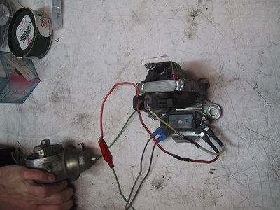

PostPosted: Thu Apr 25, 2019 9:36 pm
You need a trigger, distributor is easiest, a coil and a 12V power source. You're mocking up the ignition system on the bench.
