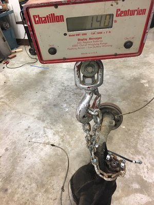

I pulled the 7-1/4 out of the Valiant tonight...after 52 years of service it's headed for the differential rack outside.
Though I'm a fan of the 7-1/4, I'm changing to an 8-3/4 for a few reasons.
I have a big pile of 8-3/4's I need to make use of before I die
I wanted the big bolt pattern
I have a bunch of third members with different gear ratios already
But....the 7-1/4 has some distinct advantages...it weighs less and rolls easier. For the average A body with a Slant Six..it's plenty of rear end.
So, when I get the 8-3/4 all together I'll weigh it for comparison. I'm expecting it to be about 60lbs. heavier. That's serious poundage. Here's the complete 7-1/4 - brakes, drums, parking brake cables, etc.

60 lbs is about right. If there were strong limited slips and gears available for the 7.25, then I would have one in a car.

Likewise. I have been a fan of the 7 1/4, but the parts just aren't available any longer. I had one with 5.13 gears that I am rebuilding with 3.91's. Everything in it is brand new except for the spider gear cross shafts (just not available). Took me about a year to find all the parts and cost somewhere around $400. And I haven't seen the SG clutches for sale in many years. I had one set on hand.

8.75" is about the same wt as an 8.25". Maybe 10 lbs heavier?
