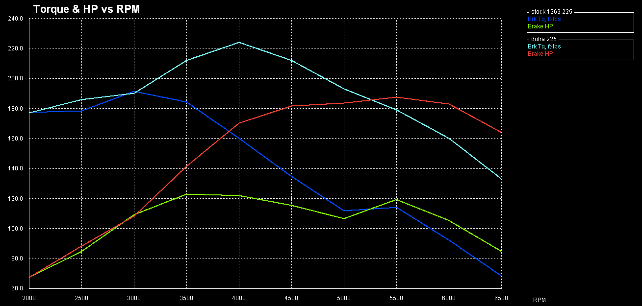

PostPosted: Mon Aug 05, 2019 8:39 pm
Joined: Wed Jul 31, 2019 7:14 pm
Posts: 25
Location: Sonoita, Az
Car Model: 1963 Dart Convertible
Just for fun I put what I think the stock 1963 225 and what SlantSix6 recommend for a build into Performance Trends software to see the difference. A few parameter are guesses but they are consistent across both models. Not a bad improvement!
