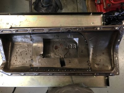

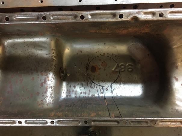

and this is what I did, a simple baffle to stop the oil in the sump from flowing out of the sump on extreme latitudinal or longitudinal transitions.
* I started with the pan, and pick up I was planning to use and a bare block,
installed the pick up and pan and reached down through the cylinder bores
with an extension on a Sharpie and traced the profile of the pick up base and tube

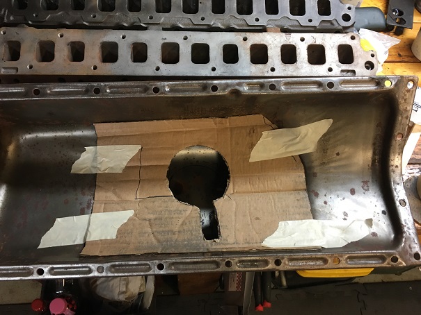

** Then made a cardboard template to fit the sump and redrew the traced profile on the cardboard
*** Used the cardboard template to make a baffle from a piece of 24 gauge steel that I had available
**** I enlarged the oil pick up base opening, as I wanted to make sure that I had a good path to get oil back in the sump.
I am set to use a windage tray and up and down crank scrapers.
***** Taped the baffle in place and made a test fit trial with the open block. Then welded the baffle to the oil pan.
The dip stick clears into the opening easily.
****** Had to make one final adjustment to clear a windage tray mounting stud, and the pan with the baffle fits fine.
I started this project yesterday afternoon and finished it today.
File comment: pan with pick up tube trace

File comment: pan with cardboard template
