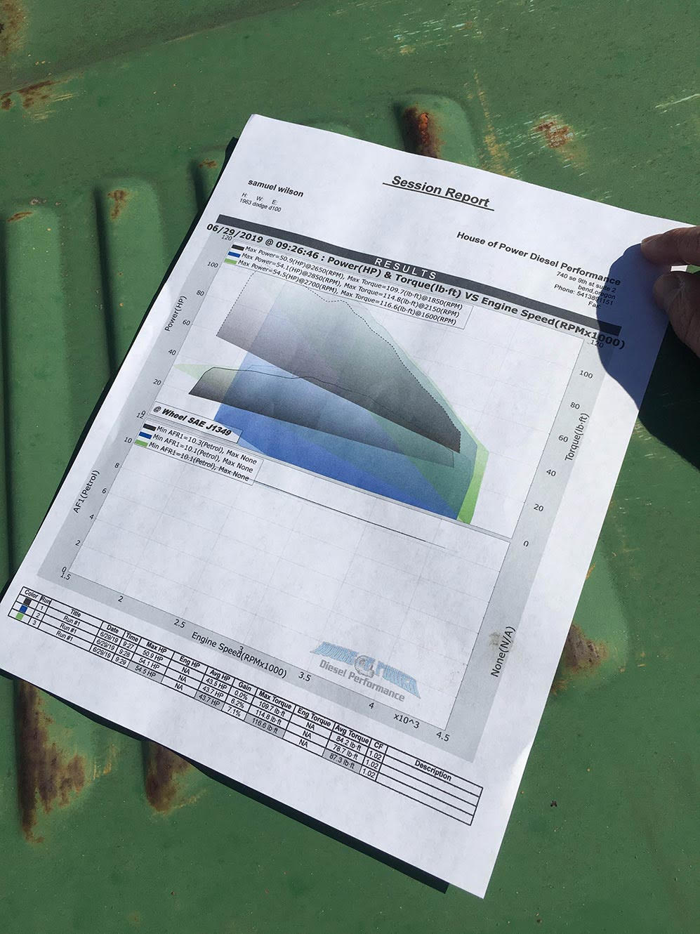

I decided to put my 1963 D100 with a stock slant six on the dyno. I thought y'all might enjoy the sound of it pounding out 55 furious ponies. :lol:

55 hp? That is pretty anemic. Is it a high mile motor?

Looks like it's running rich.

Farmtruck states has a flat cam lobe.

It's all original, sucking air through the oil-bath filter and untouched carb. And has one intake lobe worn to a circle. Given the condition, I wasn't expecting much more. What's hilarious is how little hp it made at higher RPM, it was down to about 32hp by 4000RPM. It made that 55hp at a mere 2700RPM, peak torque was 117@1600. :mrgreen:

Well, that explains it. At least you can say you can easily double the output of your engine and have it still be naturally aspirated.

Josh, you could do that, but keep in mind what was posted is on a chassis dyno, not an engine dyno.
I suggest still not too bad for a half-worn-out, 60's farm truck.
