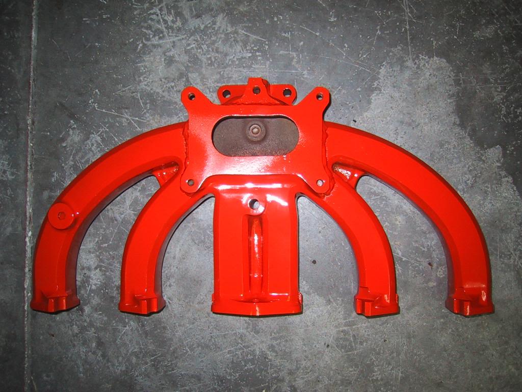

The Super Six 2bbl carb and intake is what I'd use on an otherwise stock engine. If you can't find that and are handy with a welder you can modify the original intake to accept a Holley 2300 type or Motorcraft 2bbl.
