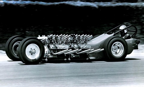

build one of these, Slant powered of course,
you have the additional advantage of the
storage being mobile.
