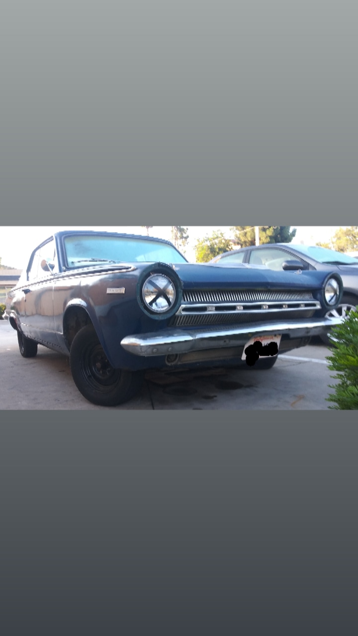

Hello everyone,my name is Adan and a teenager which is new to slant 6 engines.My dad got me this 1964 dodge dart about 2 years ago as a project car. When we got the car it didn't turn on. After a few months of owning the car we got the car running.The interior was gutted already when we got it. The engine and automatic transmission is still there. Was wondering how I could make this car built for autocross?

Hey Adan! Welcome to the Slanted Family! You are in the right place!! There are several of us that enjoy building these cars to handle. You will find lots of good information here and folks willing to help.
Is the car already running well overall? It probably still has the little 9" drum brakes, right? That could be an issue with autocrossing, but we can work around that.
For better handling:
Good brakes
Good tires
Thicker torsion bars
Front swaybar
Lots more coming as other folks see your post.
Share more about your car! Where are you located?
