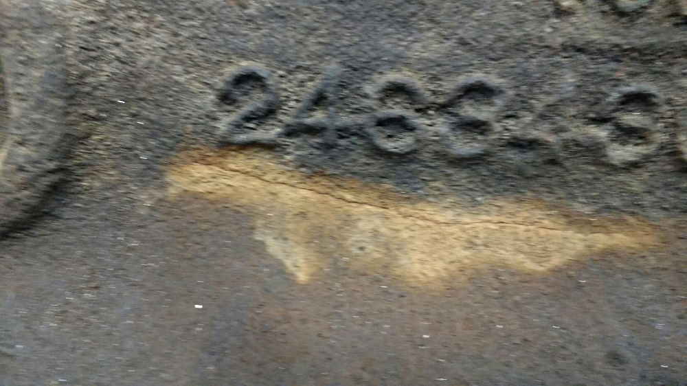

The 225 has developed rod knock on a dyno pull after making around 120 hp to the wheels on 5 psi of boost. So I've pulled the motor, and following Doctor Dodge's book, I've started a teardown. First find... this may be a sign I should be looking for another block to build instead of keeping the bragging rights that it's the original engine.
File comment: Looks like a crack under the casting numbers.

Crack, bad.
But I doubt that is the real problem if it's knocking.

Yes, I'll have more pics the further apart I get the motor. Just trying to document everything I find that's gone wrong here. There are three such cracks that I've found on the driver side of the block, which tells me I ought to be looking for a new core.

Crack is probably not from the turbo if you only made 120 HP. That is one place they can crack, although I have never had it happen on one of my blocks.

Looks to me, like it was caused by freezing.

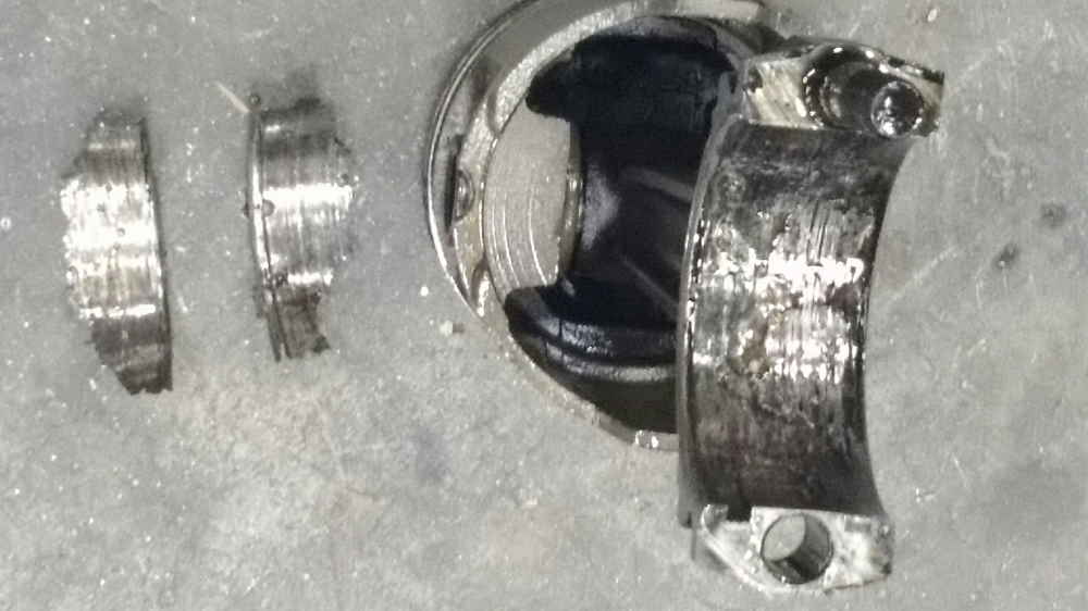

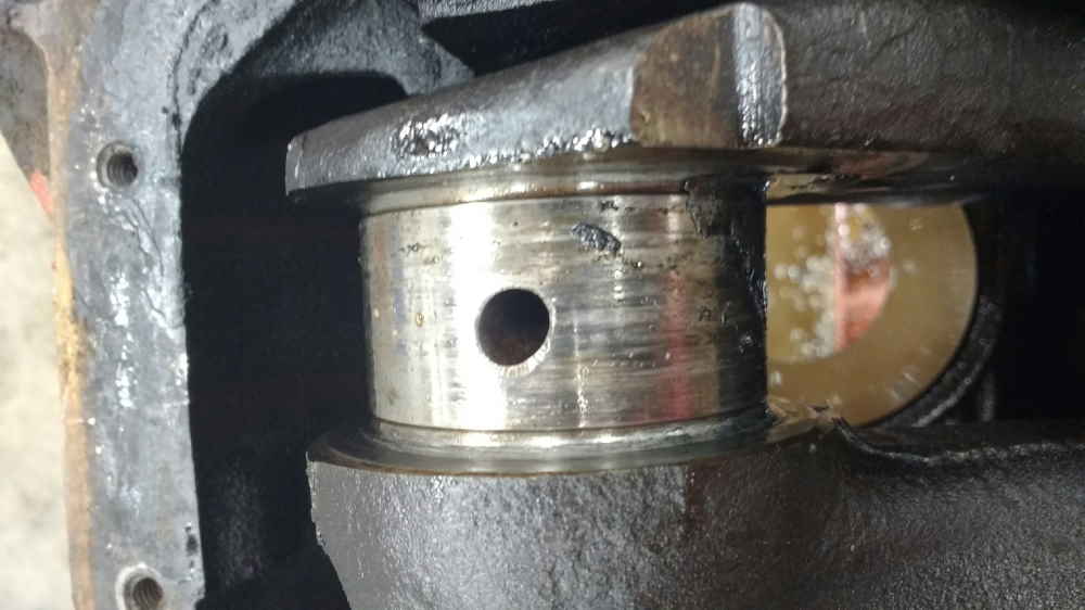

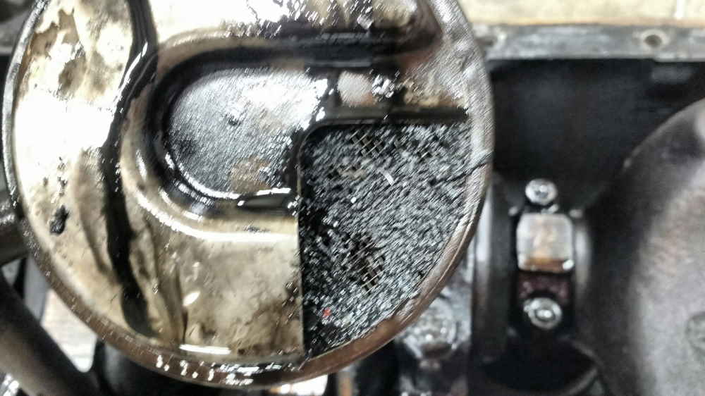

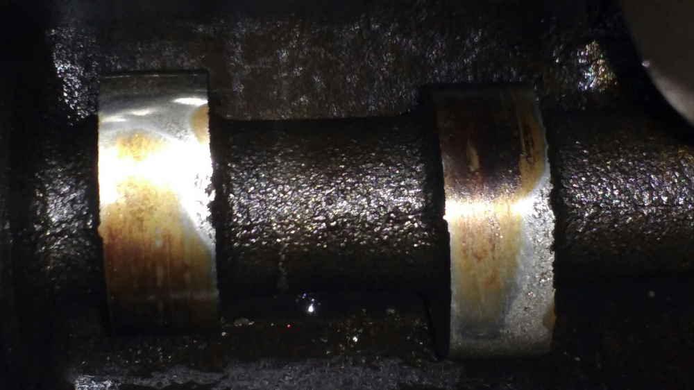

The rod knock was very definitely the #6 rod bearing. My suspicion is that the pick-up was not letting enough oil through on the high RPM dyno pulls. The crankshaft looks like it could probably be turned undersized and saved. The rod, probably not.
Also, the cam lobes aren't looking in the best of shape.

Yeah,... I’d say that con rod bearing is a bit hammered.... :shock:
yes from the photo that pick up screen was blocked, for the next motor you may want to look at the
oil pump porting mods that Doc has posted here, nothing terribly crazy, but every little bit helps,,,,
