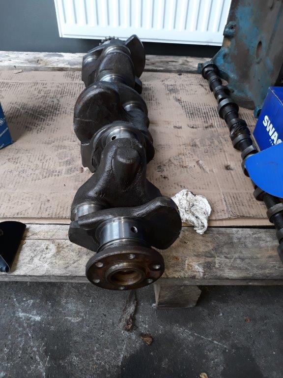

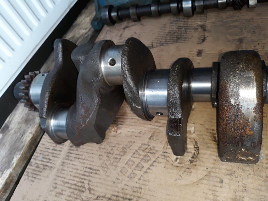

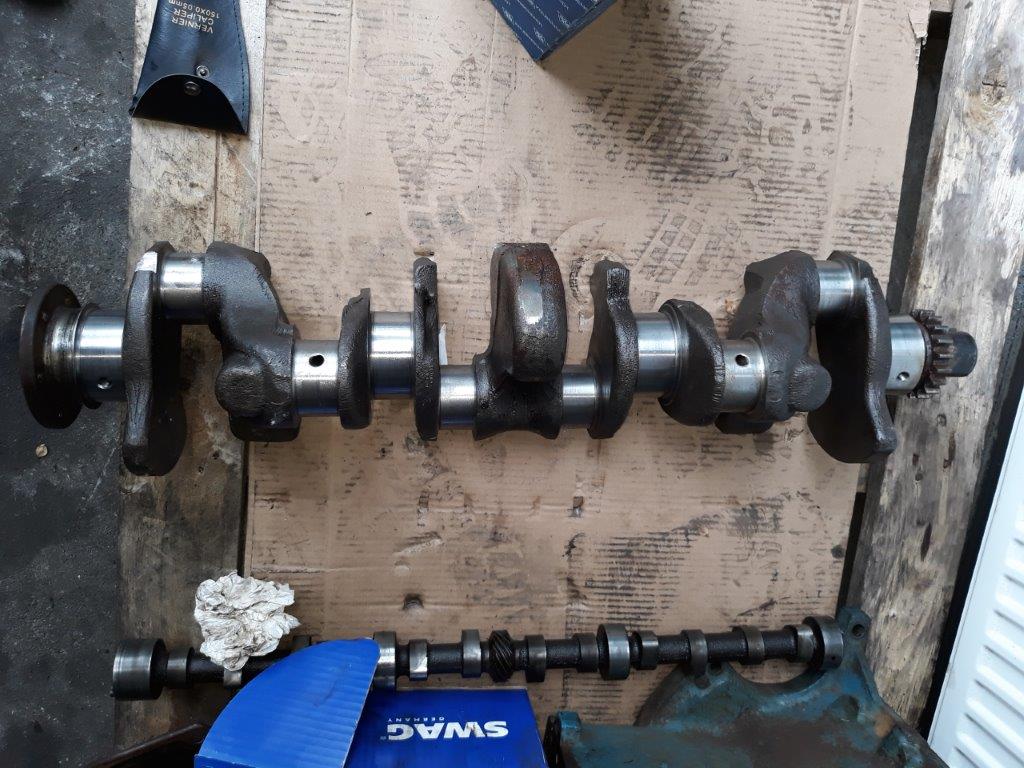

hello Gents,

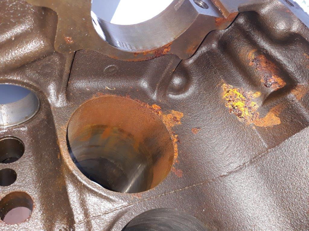

I got a 225 engine pulled from an unknown car in Australia and brought it to Europe for a rebuild project that meant to replace my 198 in a Dodge Dart. It turned out that the 225 block leaks and needs resleeving 2 cylinders. Unfortunately, after first cylinder was done a new leak popped out from the water jacket to deck between the block material and sleeve. I decided to put that block on hold for now and simply upgrade my 198 nominal block to 225 using the crank and rods from the 225 and new 3.44 standard pistons.

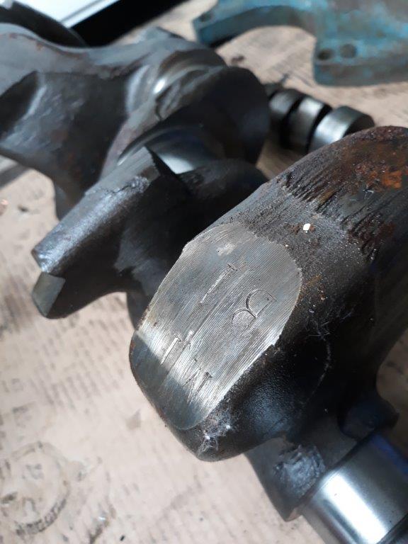

While checking the new piston weight it tuned out they are evenly at 516 grams (no pins) as opposed to 465 grams in the 73 Dodge Chassis Service Manual. Do you Guys think this is a problem?
is there anything I should be particularly aware of in getting a 225 crank and rods to an 198 block?
Thank you in advance

I would not worry about the piston weight, as long as all the pistons are close to each other. Inline six cyl engines, do not get the cranks balanced with the rods/pistons. Just go ahead and install the 225 parts into the 198 block. Forged crank 225 engines use the same block as 198 engines.
PostPosted: Tue Feb 25, 2020 4:05 am
Posts: 17641
Charlie is right on all counts. Go for it.

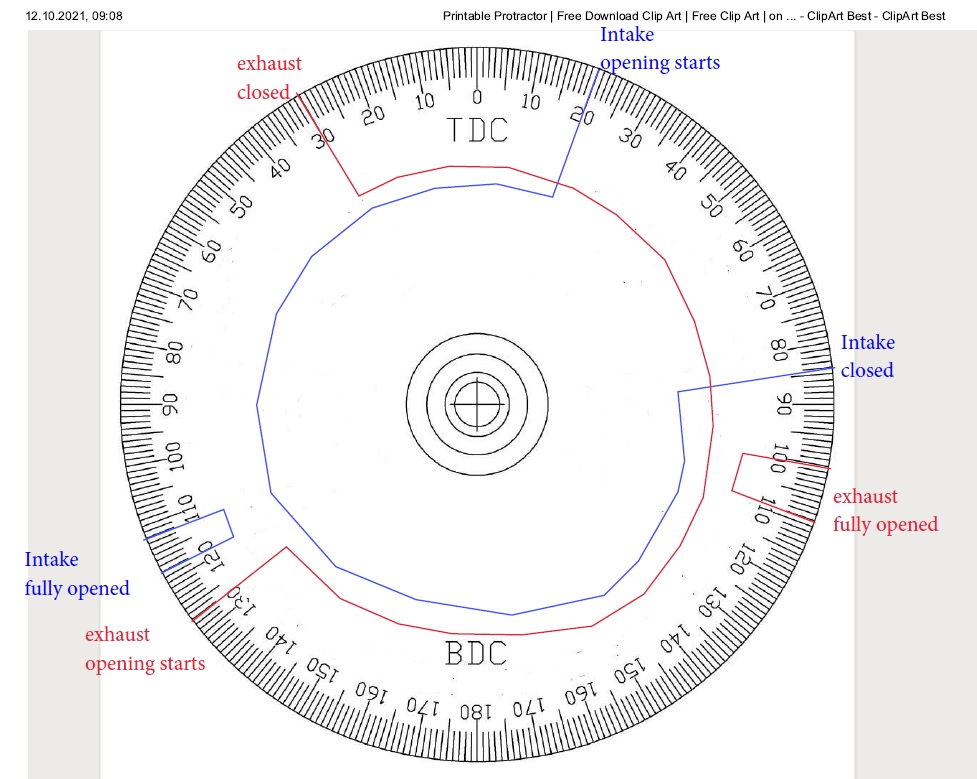

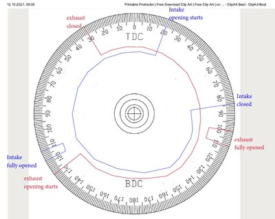

Hi Gents,
Engine is almost done and I did final checks on the camshaft and this is what came up:
intake opening: 20 degree BTDC
intake fully opened: 112-118 degree ATDC
intake closed: 85 degree BTDC
exhaust opening: 127 degree ATDC
exhaust fully opened: 109-100 degree BTDC
exhaust closed: 30 degree ATDC
The engine is defacto built to factory standard Super Six with Carter BBD and 0.040 pistons.
I am not sure about this camshaft as it came of from an engine in Australia and I dont have any specs for it.
Could you give me an idea on what this camshaft is and what I can expect from the engine running with it? Will it move the car?
Thanks a lot :)

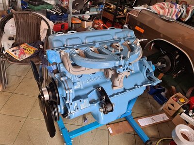

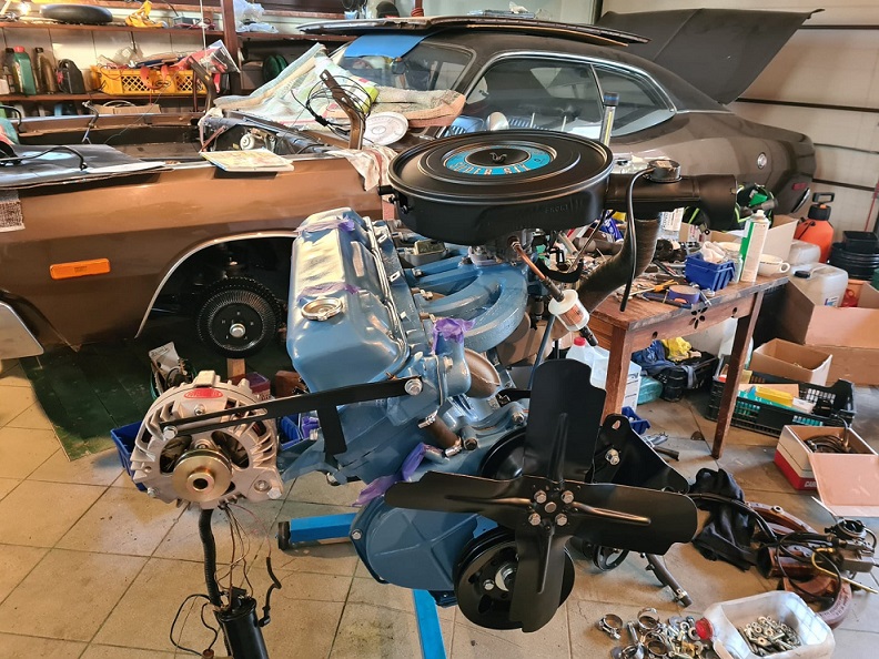

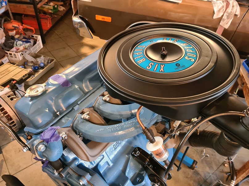

adding some pics of the engine

PostPosted: Tue Oct 12, 2021 5:38 am
Posts: 9166
Very cool project! Others will surely chime in with ideas on the cam.
You have a unique project for Europe! I was very tempted to take my 1972 Dart Swinger with me both times I was stationed in Germany.
PostPosted: Tue Oct 12, 2021 5:50 am
Posts: 17641
It looks like your cam is about 10 deg retarded. It should be in the range 104-108 deg at peak intake opening. You might be one tooth off on the timing chain. What is the lift? Measure side-side across the narrow part of the cam lobe, then base to peak and subtract those numbers to get gross cam lift, then multiply by 1.5 to get valve lift.
Maybe someone else can check my numbers, as my head may not be working yet today...
Engine looks great!!
