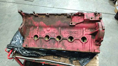

Although this is the fourth turbo combination I've run, it's my first engine rebuild. Thanks to coconuteater and Charlie S for donating several parts, and also to the others who'd offered to help. Today this build got started with dropping the parts off at the machine shop. One BH code block:
File comment: One BH-code block

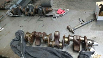

And two small torque converter cranks:
File comment: Two small torque converter cranks

Yes, I picked up the block (and rods) from Coconuteater. But it's being paired with a small torque converter flange crank so I can keep my current transmission.
It turns out the block had already been bored 0.030" over. But the pistons had some seriously weird damage to their tops - maybe detonation pitting, but it looked like they'd been damaged by something else. I could almost have done a hone and reuse job if I'd trusted the pistons not to crack, but instead I decided to have the block taken to 0.040" oversized.

Strongly suggest boring to 0.060" over.
PostPosted: Mon Apr 06, 2020 11:49 am
Agree, the .060 over bore is enough to actually de shroud the valves,
Although anything helps.

Unfortunately, I've already got the pistons and the machine work done. This will let me save the 0.060" overbore if I end up with a Mark Five built with custom forged pistons and 198 rods, though. :) I'm a bit surprised that a 0.010" difference between the valve and cylinder wall would change flow so much; my thinking was that a little extra wall thickness would help with ring seal.
just going .020 over probably helps, so .040 over helps more,, .060 a little more
David Vizard has a clearance where the bore no longer influences the air flow,,
I will see if I can find that.
